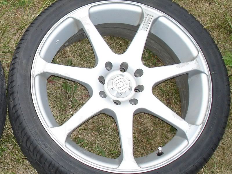

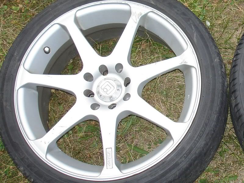

BUT ANYWAYS.. back to the question... whats the best way to paint these up? im not sure WHAT they are made outta and some scraps are all the way to metal... should i use any kinda special primer... or just regular primer then paint?
im gonna start sanding on them tomorow and get them looking at least decent and then paint em up black

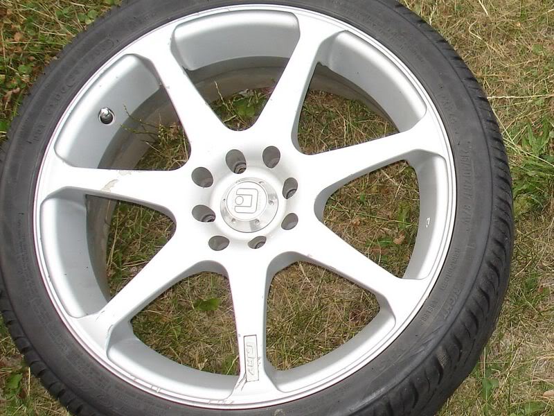

as far as gouges int he metal, you can use a grinder or something to smooth it out. I never tried using any kind of filler or anything, because I didn't care [8D]

I used filler, they came out really well...then i decided i didnt want teh rims anymore and sold them,but still, the filler workd well.

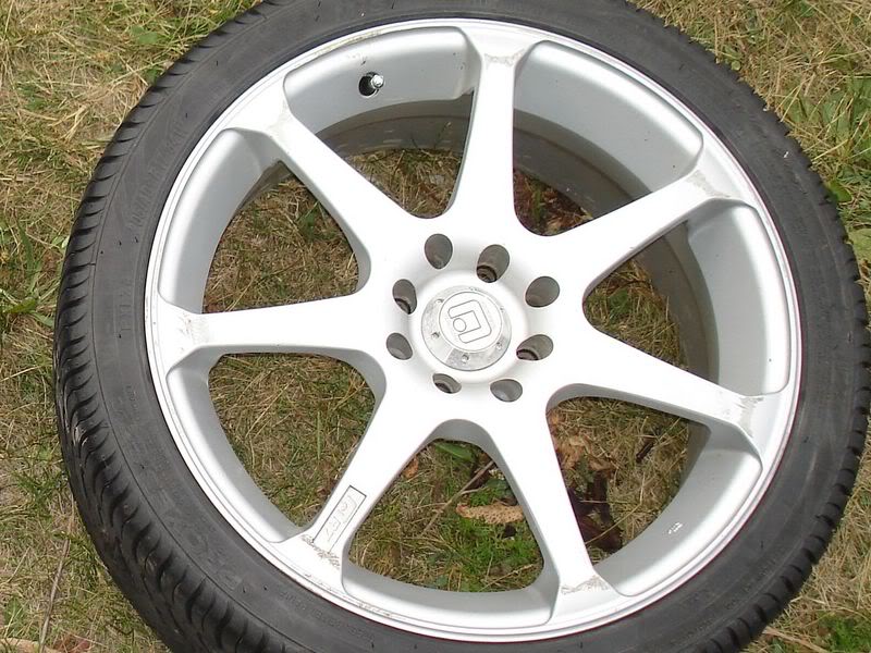

paint stripper wont damage the wheel and shouldnt damage the tire. tho i'd still tape off the tires to protect them anyways and also the valve stems. tho if u do use paint stripper, i think u'll need to primer. any rattle can should be alright but i'd use wheel paint or hi-temp paint just so it dosnt leave cracks or chips away. ur prolly better off buying some good all season tires than actual snow tires, it'll be cheaper and alot easier to find.

yeah I think the wheel paint is more resistant to rock chips, they also make a wheel clear that you could put over some other color.
use primer first if you get down to bare metal.

well... so far most these curb swipes are coming out great! ive got 2 rims just about done.... but need one more can of wheel paint... so far ive gotten out every harsh scrap besides one thats REALY BAD near the tag... so i just got them the best i can... no big deal to me... they dont have to be perfect!
