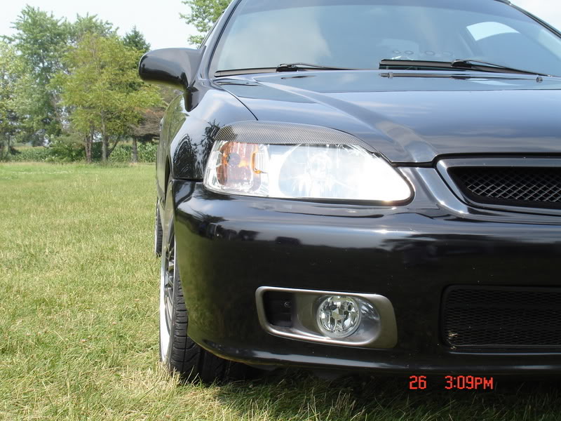

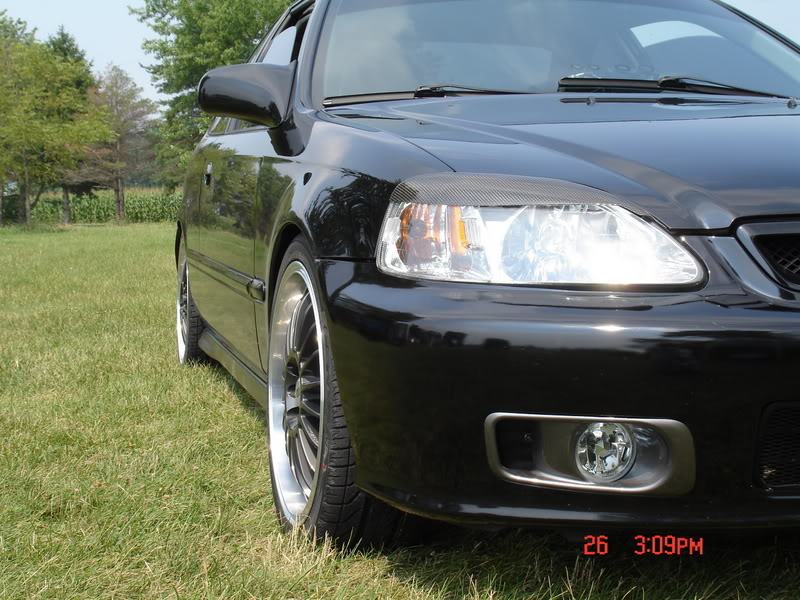

my 17s are 42offset and they tuck preaty nice..

So when did you plan on mentioning that you rolled your fenders cause your wheels were rubbing?

he didnt say he was lowered to tuck tire... my guess was tucken the whole wheel...
and my front realy isnt rolled just pushed up on the tabs alittle bit... tho the rear fenders are rolled... but then again my camber is correct as well... most people rock negative camber and clear...

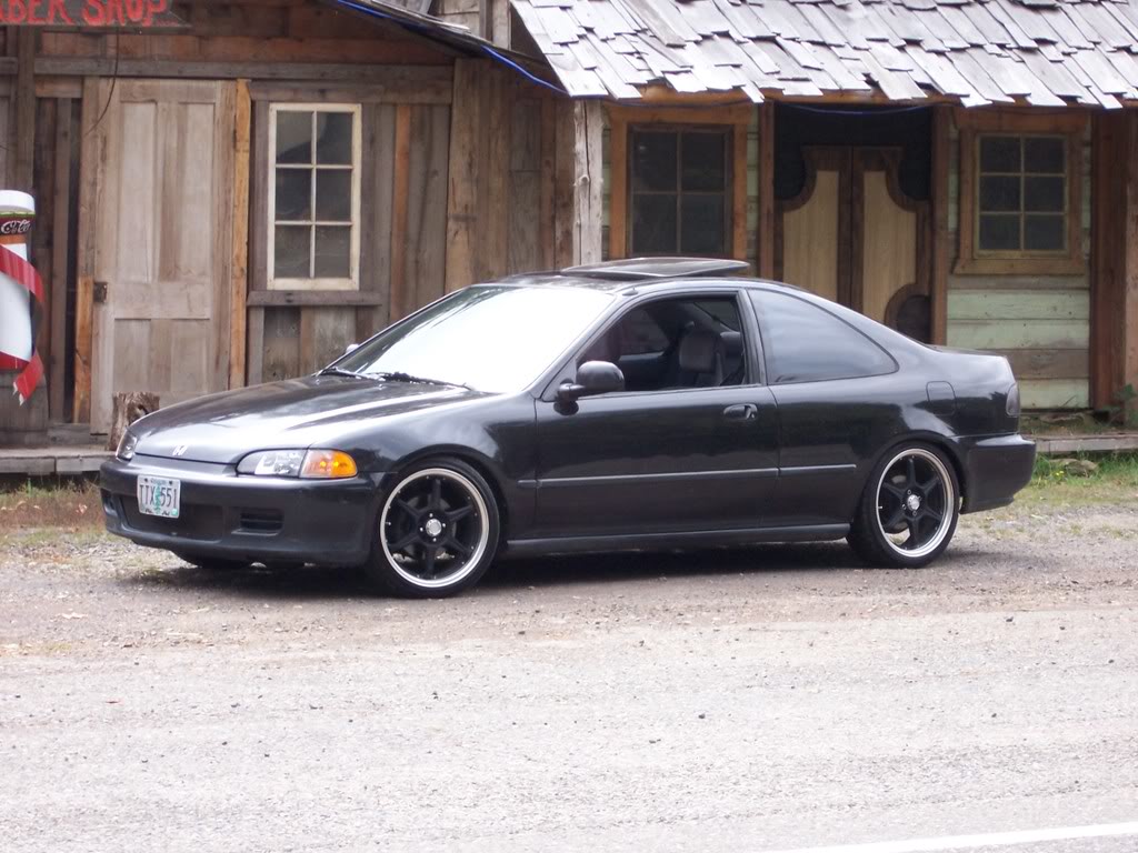

**Edit: Either way to the OP... as was stated in previous posts more +offset = wheel is farther in...so go with the +42. addiction's fenders are rolled with corrected camber...mine sits nearly the same and when I had the 17's that were +42 with a little negative camber I never had a rubbing issue and my fenders are not rolled.
***One more edit...here's a shot of mine with the 17's...remember my rear camber was not adjusted so its negative...but I have no tire wear issues so I see no need to fix.
