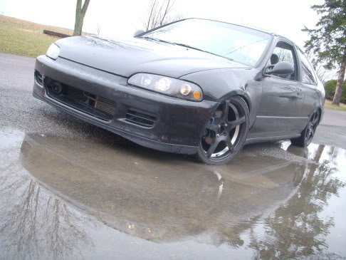

Yeah, like I said originally, the first ones you posted would be my top choice of the three. I believe you said the 15's had a +40 offset (correct me if I'm wrong)... what's the width? Are they 15x6.5" or 15x7? If they're 15x6.5" I think a +40 offset should be high enough that rubbing shouldn't be a concern, even if you slam the car. If they're 7" wide you might need to roll the fenders, but if you're moderately lowered it shouldn't be a huge concern. I had 17x7's with a +45 offset on my ej1 with no rubbing, and that thing was slammed (and going by my usual picture-***** fashion, you know pics are coming ), so a 6.5" wide wheel with +40 offset should be fine.

God I miss that car

reaper i remember seeing that car a while back when i found this forum, def a sick car.

And a +43 offset on a 7" wide wheel is actually more or less perfect; you shouldn't have any rubbing problems at all with the right size tire.
*edit: Fun fact of the day: The second picture I posted of my ej1 was actually taken in almost the exact same spot as my siggy, just closer to the road
