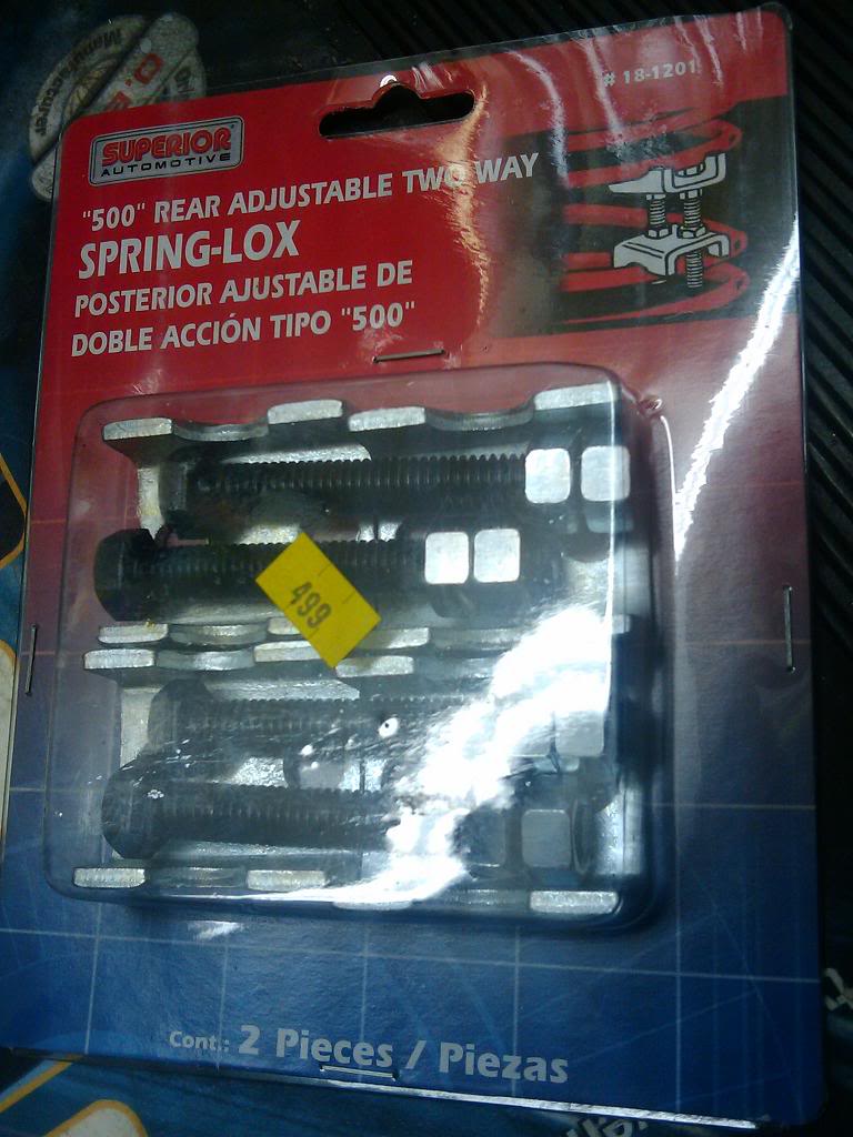

heres a pic of these spring-lox, what do you guys think??

It's April 1st, but what the hell...don't even think about it. You can't safely raise/lower a vehicle with store bought parts totally < $30.

the only solution is to buy new springs, dont waste your money on this crap. Someone was selling h&r springs in the forsale section for dirt cheap. Spend a few extra and do it right

lol they look like mini spring compressors, doesn't look too safe at all. judging by the diagram on the packaging looks like they can pop off after driving for a while. if your looking for a 1-2" drop get some tein s-techs, or some other lowering springs. those ebay springs, are no name right? i it is, i wouldn't trust them on my car, you never know when or what they will do.
