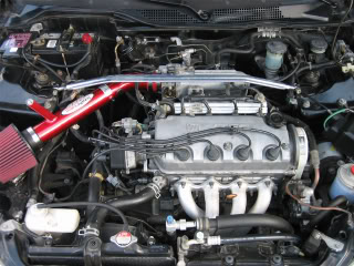

front upper strut bar

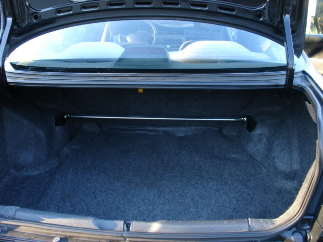

rear upper strut bar

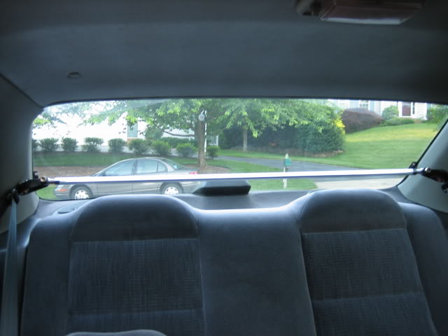

c-pillar bar

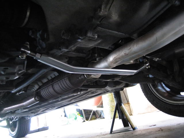

front lower tie bar

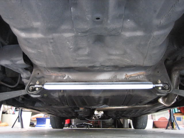

rear lower tie bar

i figure these pictures will also help answer many questions on where and how they are installed because i know i had a bunch of questions on where the bolts were located before i purchased them.
hope i help!

was a good deal. still got all them bars in and am still very happy. and like i said before, if u drive ppl around alot and stuff then c-pillar might not be a good thing. BUT, u can always take it out for street use and put it back in for racing since its just 2 lil bolts and takes such little time to install. my friends always hit their heads on it and it is a saftey issue cuz if u get hit, the whiplash will nail their heads into the bar...but i dont drive ppl around anymore so its all good.

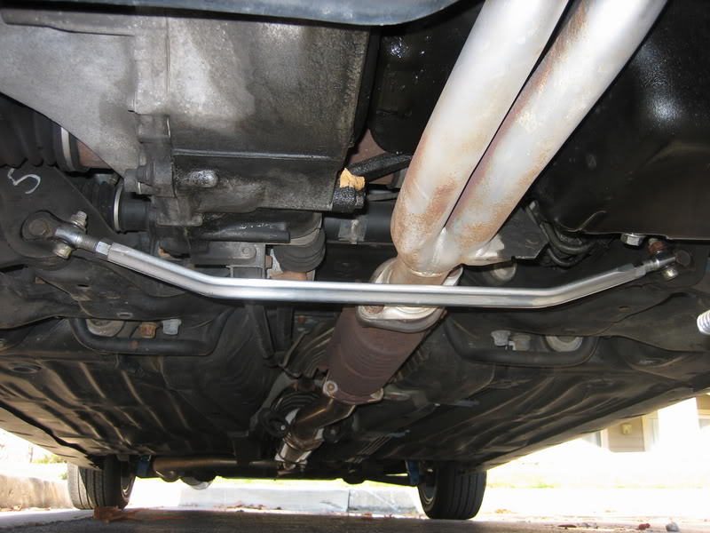

heres a better pic of the front lower tie bar.
