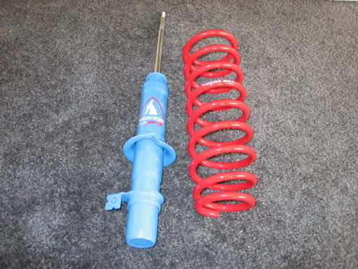

Product: Tokico HP Advanced Handling Kit

Installation: not to complicated but you will want an extra hand to help you out. If you feel at all uncertain about the installation, I highly suggest buying a Haynes or Chilton manual. As far as tools, u’ll need: sockets, wrenches, some kinda breaker bar(for those stubborn bolts), PB Blaster/WD-40, hammer/mallet(maybe), set of allen keys, and spring compressors(2). Air tools will help things go smoother.

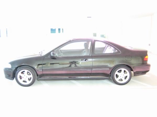

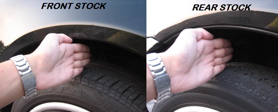

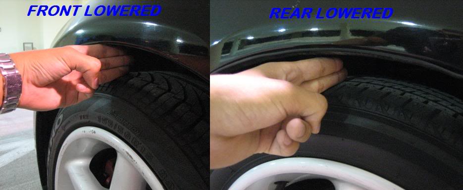

Review: In the end, after all was said and done, I must say I’m satisfied and happy with the results. It drops the car about 1.5” all around which is great for me because I drive this car daily. It also handles waaay better. Ran with 11yr old stock suspension and man wut an improvement. Less body roll, better steering response, smooth transitions(like in slaloms), less wheel hop, and great/comfy ride for daily use. This is a great setup for someone on a budget yet still strives for the great handling.

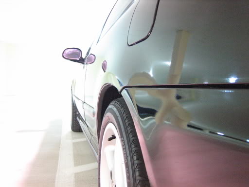

Only thing I might see ppl having a bit of an issue with is the way it drops the car. The rear gap is about a finger lower than the front. Either way it’s not bad and hardly noticeable.
Before:
After:

I'm waiting for the same set.But don't know why rear lowering is more than front.
That what I read about Tokico HP & springs is 1.4" lower front and 1.25" lower rear.
Anyway I think too much lowering in front is not that goo, because the front is heavier than the rear.

Looks great. I don't know how I feel about the back being lower than the front but I'm sure nobody will notice it if you don't tell them.

I read other forums too and I read that lowering more the backis tend to help for oversteer in agresive drivinglike autox.
This is very good for any car especialy fo FWD car, which has a lot of understeer.
Actualy any stock car suspension is set for understeer, sowith lowering a little the back you dive more traction to the rear of the car and reduce the understeer, which is great!
It's not too much to looks ugly, but it makes a sense!
