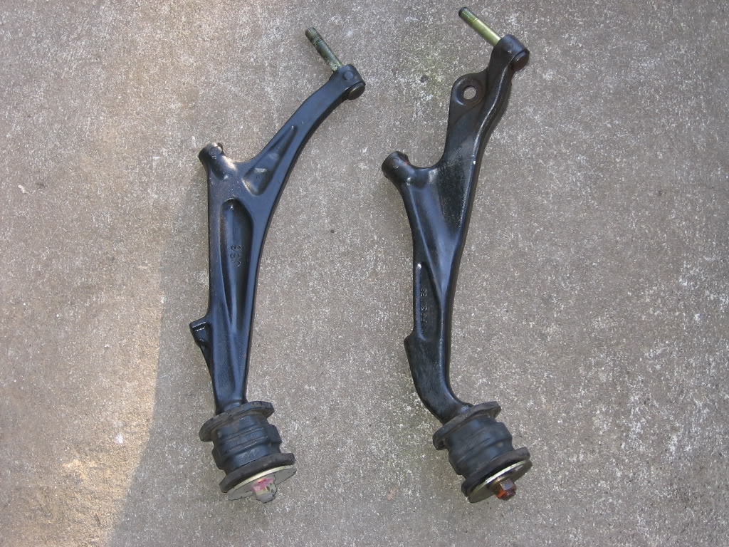

make sure your lower control arms have a hole in them (see pic)

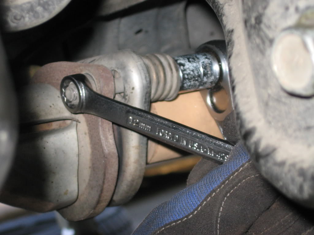

unbolt exhaust at the cat (refer to pic)

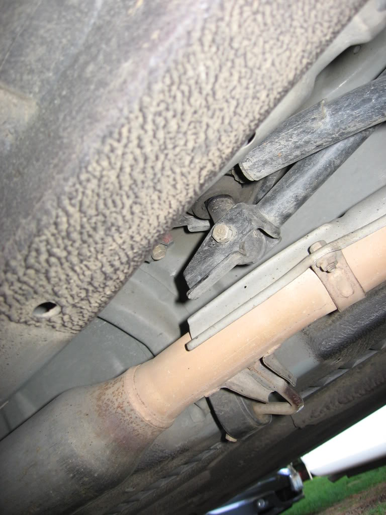

unbolt shift stabilizer and let hang (refer to pics)
unbolt shift linkage (pic 5)

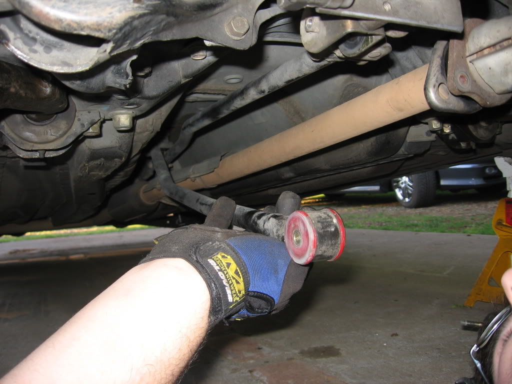

lubricate urethane bushings and place on the sway bar
place sway bar in its place with the hump above exhaust and shift linkages

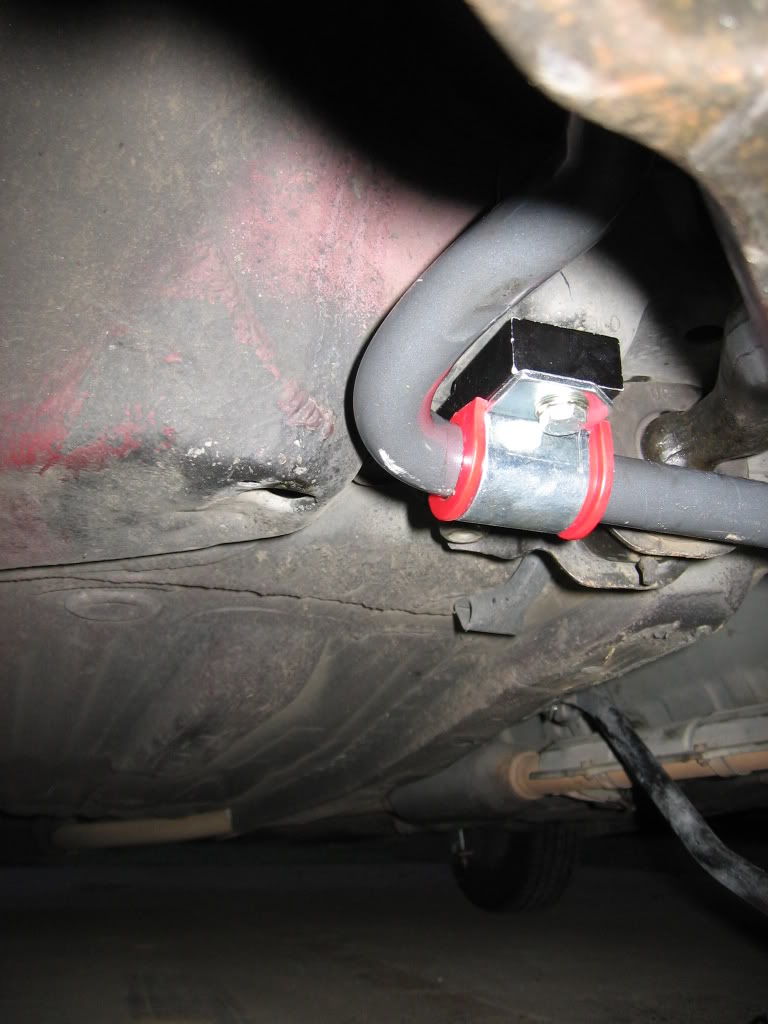

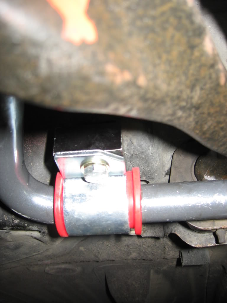

place aluminum spacer under bushing and the steel u shaped piece over the top of the bushing and bolt them in place on both sides longer bolt goes on the side that is thicker (pics 6 and 7)

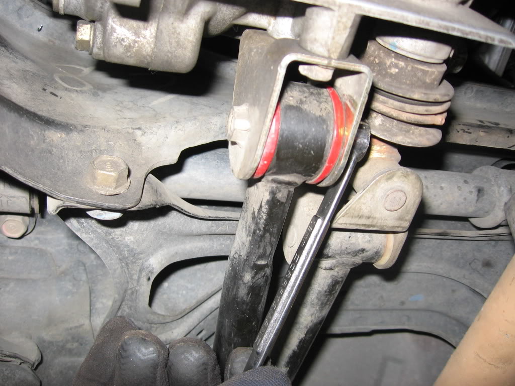

lubricate end links and bolt in to place through holes in lca's make sure not to over tighten you wand them to just start to bulge over tightening can cause a failure
