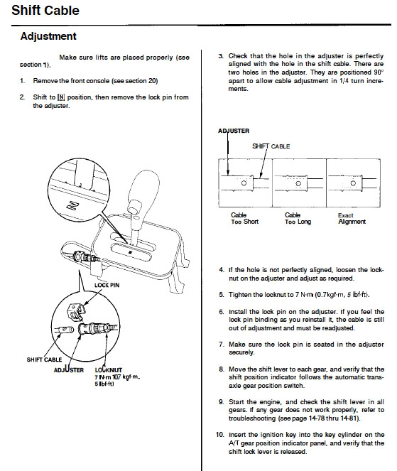

Also check whether the shift cable is out of adjustment:
