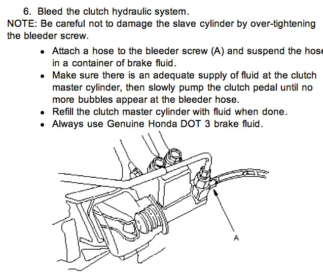

Could be a bad master cylinder or slave cylinder. Do you see any leaks?
Here's the bleeding procedure from the manual:
