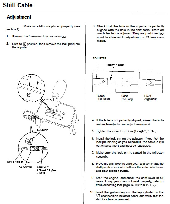

I had similar problem with my 98. Shifter worked fine then one morning shifted really stiff. The shifter cable (runs between shifter and transmission) was the culprit. Minor fix compared to tranny.

Default RE: Transmission Problem
