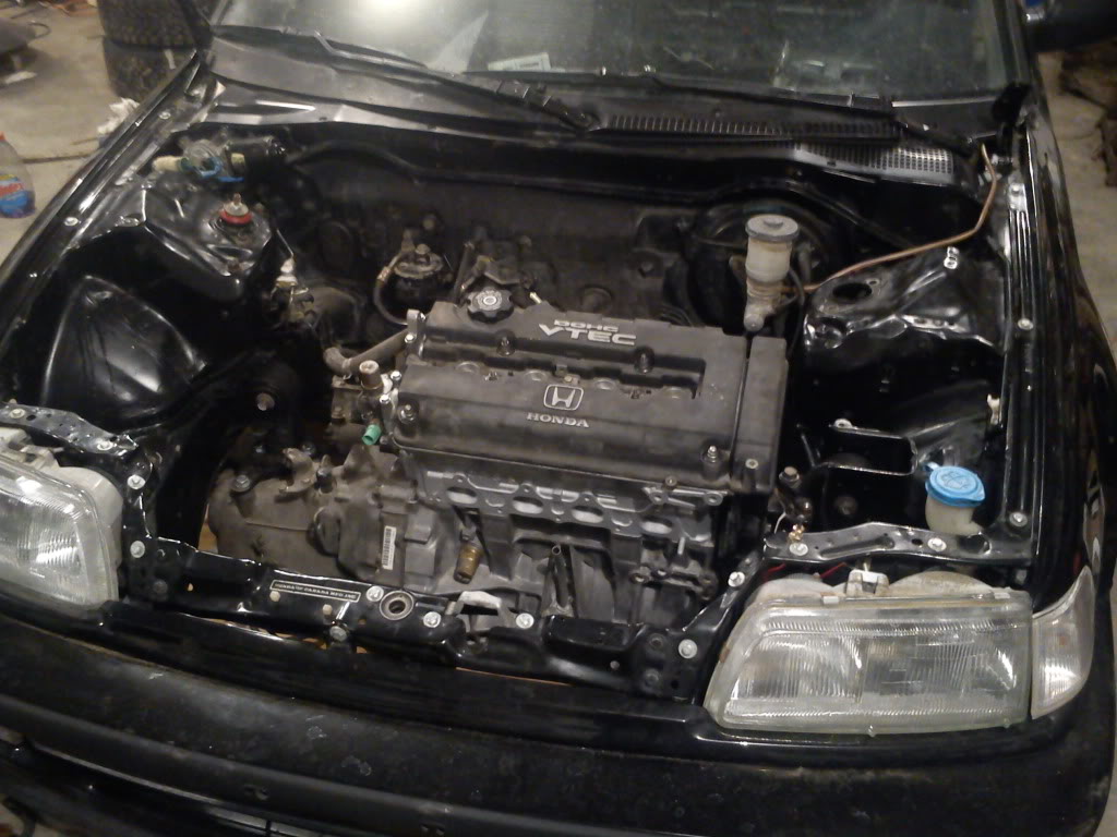

Motor is in.
Machine shop broke a dowel pin for the flywheel. I had to make a replacement. I couldn't find one to buy. I cut a drill bit to size. It worked. Hah.

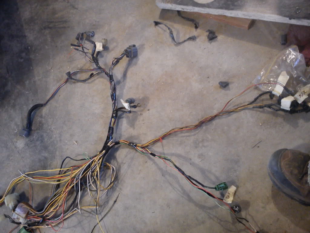

I started work on the harness...
Mocked up. I need a 6 pin plug to make an injector subharness... And a 50 pin amphenol connector.

Motor is in.

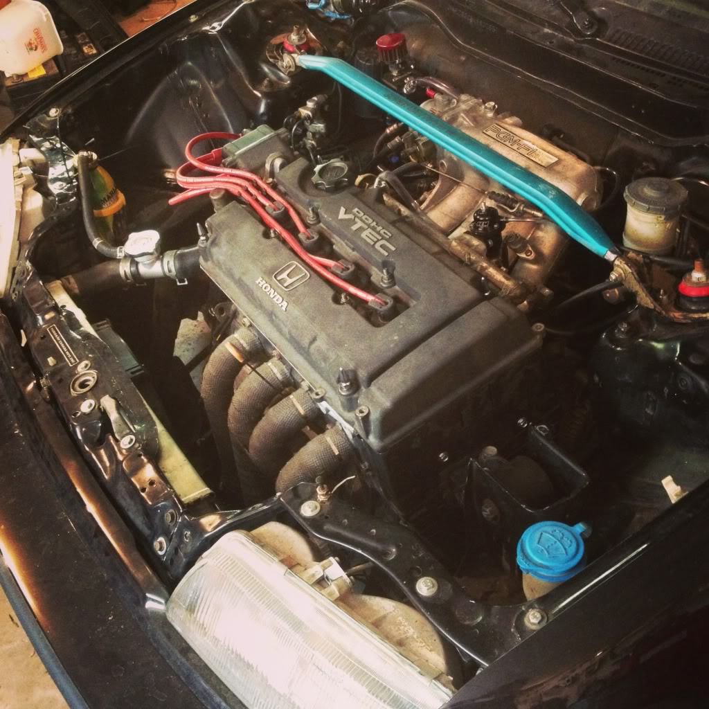

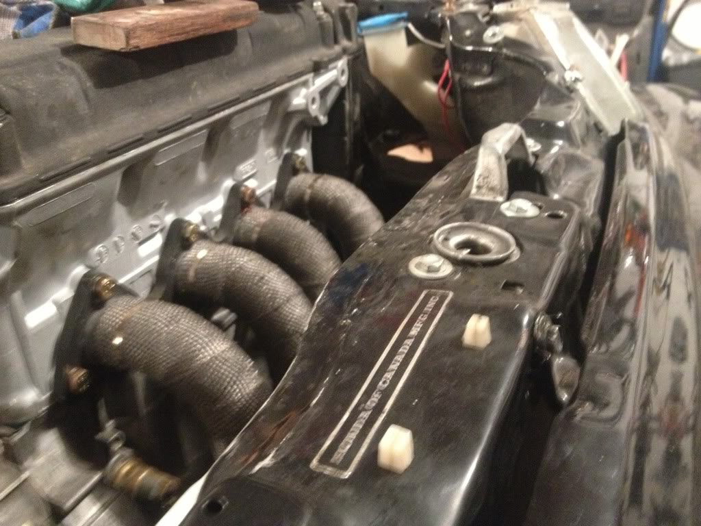

I found a DIY for putting a tucked rad in my car. Here's how she is coming along. It's a really simple swap. The rad cost me $100 locally. I've still got to find a plug for one of the holes in the rad.
Here you can see the huge clearance difference. There's no way I could have fit a turbo, or even this header, without this rad.
Right now it is just sitting in there with two holes in the lower rad support. I had to flatten the hood latch bar, remove the vertical support that joins it to the lower support, and finally drill two holes in the lower rad support for the rad to fit in. I found this DIY on realhomemadeturbo, but that guy has an aftermarket crossmember and no lower rad support. I wasn't sure if it would fit to be honest. I got lucky lol.
I've ordered a remote rad filler neck so I can still have a rad cap.
Oh yeah and I installed that heat wrapped header ha ha.
Still way too much to do...
So here she is as she sits. I don't know which strut bar I'll run. The blue sorta looks nice because it is so tacky.

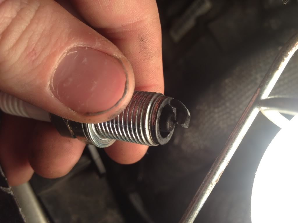

I turn it off and pulled all the spark plugs out. Every single one is coated in black soot.

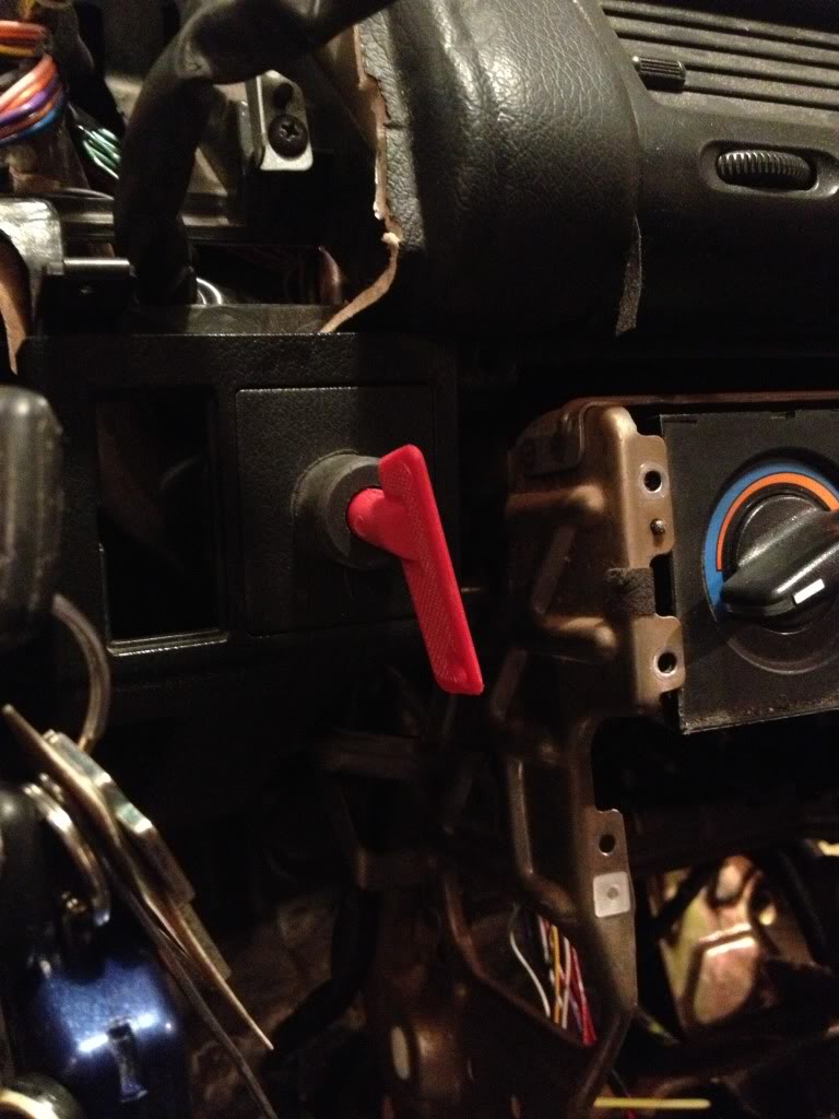

Oh, I figured out my battery cut off switch too. My alarm still works with the cutoff removed. YAY.

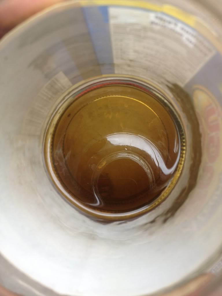

Here's a picture of the oil I drained out. I think it looks a little milky.
Every spark plug looks like this.

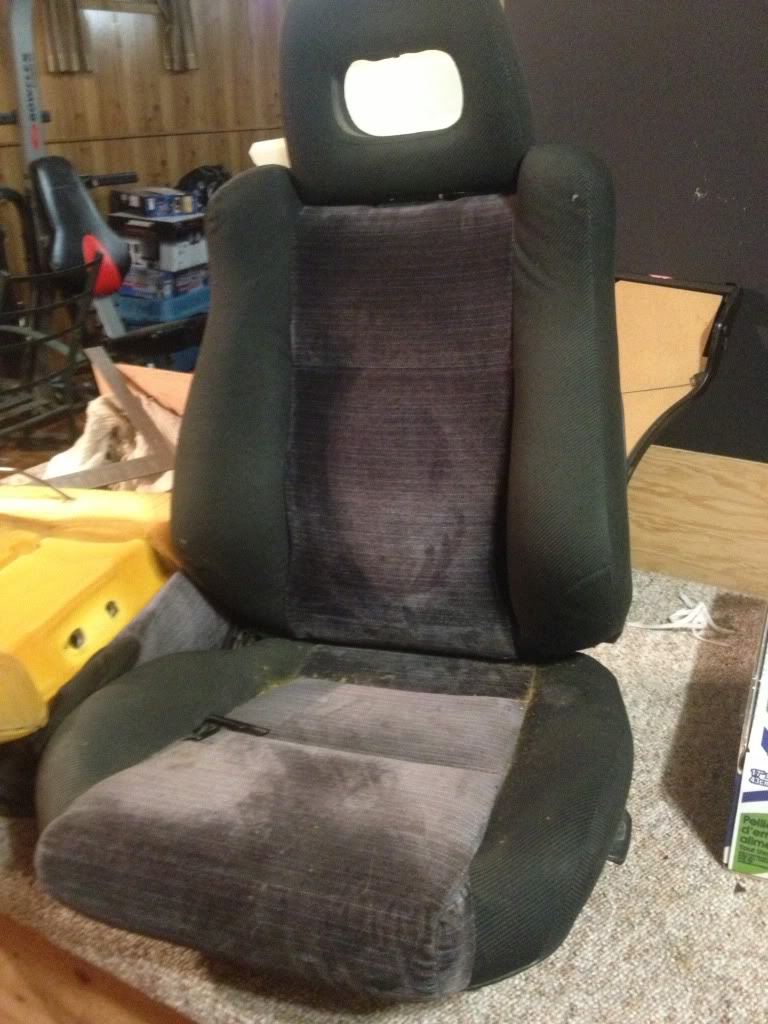

Freshly repaired drivers seat.

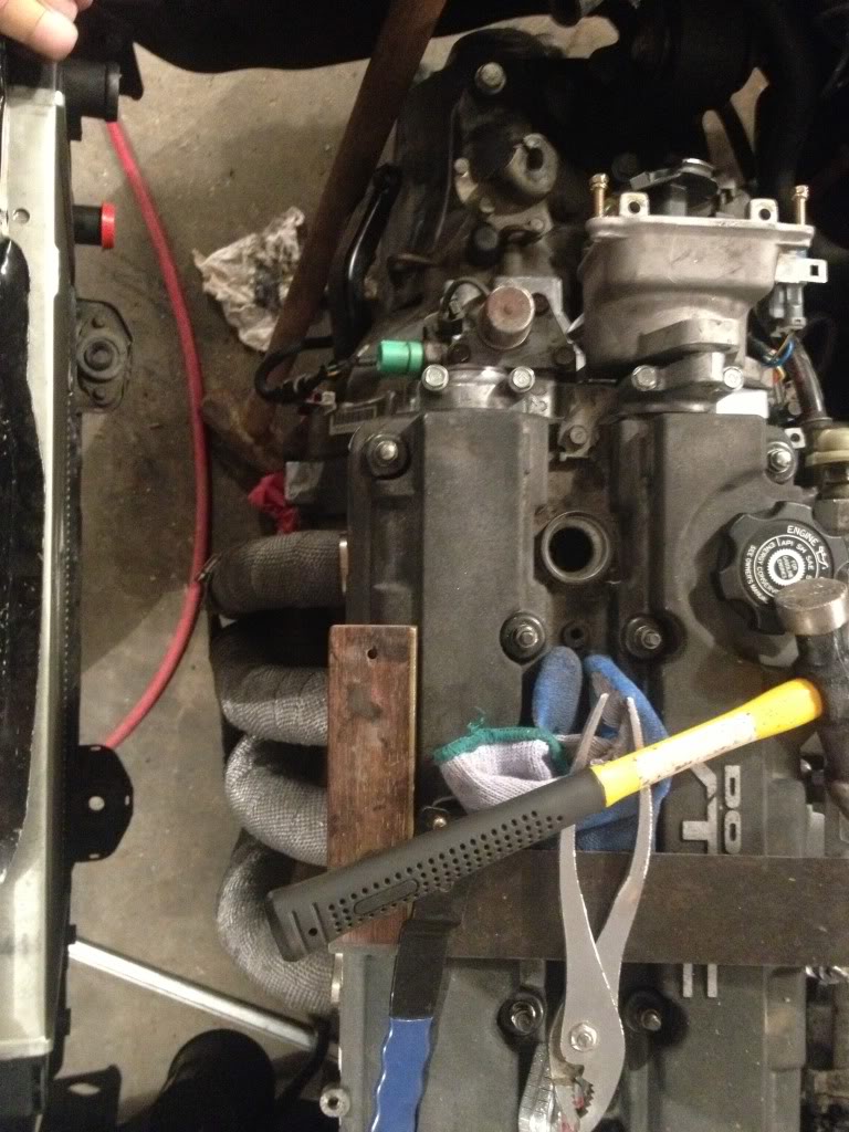

I installed the HG upside down. I'm not ashamed to say it. I screwed up lol.
I fixed it and sprayed the HG with Permatex Copper Spray A Gasket. No bubbles in the coolant... Didn't overheat either. I don't think my fan is kicking in however... And my driver side axle seal is leaking... but the B16 is alive and kicking.
