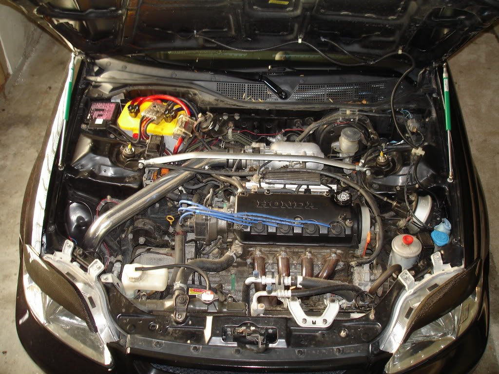

and just the brain of the alarm if they can reach the wires and they VISABLY DO NOT BELONG thats where the thief will start to cut or rip out.....
so if your engine bay looks like this... which wire do you think goes to the siren
LOL yes the little red wire. ya i was to lazy to do it right on my 99 plus i ran out of wire so its still like that to this day.LOL
for under the hood use black wire to keep it less visable and zip tie or tape the wire around the factory wire looms or even inside the wire loom where visable.
and as to under the dash after all the wires are conected and the alarm is FULLY TESTED OUT THEN you can bust out the electrical tape once again and tape up every inch of ALL of your new wires. this will make it hard to see if the thief just looks under the dash it will all look like stock wires, and SECOND locate the alarms brain HIGH in the dash!!!! as high as you can and zip tie all the wires and the brain high up in the dash as well so that no one can just pull the wires/brain down.
the way i do it i pull the knee brace under the colum and run the wires around it and zip tie the alarm wires to that brace. it will keep the wires TIGHT and out of reach as well as keep the alarms brain being able to reached even if they rip the plastic trim off the lower dash
