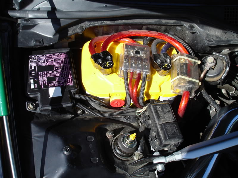

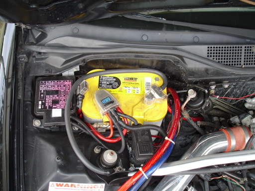

when i custom wired up my battery in my old civic i used a 4fuse block to keep even the factory wires safe from shorts since i did modify the wiring slightly, just as a precaution. i dont like to fool around to much with the main battery source!
this WAS my overkill setup. cost me about 100-150bucks just for the battery terminals and fuse block and fuses, not including any of the wires. which those are some fatty 1/0 gauge wires. only thing i never finished upgrading was the main amplifier fuse block. just a crappy block i had laying around from a old install...
but i do love those MIDI fuse blocks! so compact it works great anywhere! and have a fuse for quite a few ratings (30, 40, 50, 60, 70, 100, 125, 150, and 175)
so if you want to save some space under the hood or in the back from a bulkier fuse block check out some MIDI fuse blocks...
sure beats the hell outta this mess that i had temporarily... tho it did work it just looked horible!!!!
