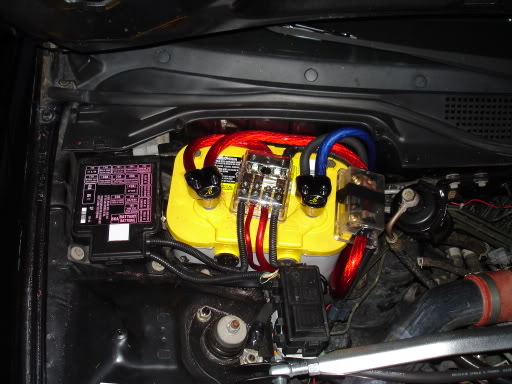

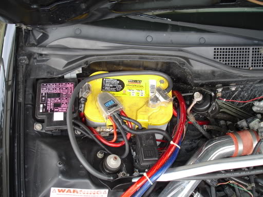

for my battery i did several things....
tho i did spend like 100bucks alone on just those terminals and fuses... no wires counted in the cost!
beats the hell outta my cheap terminals i had!
thats just a mess!!!!!
and the way my toys are wired up is a 8gauge wire ran into the car and into a distrobution block... and some simple inline fuses for anything i connected to it...
the only stock wire that is not protected by a main fuse is the starter wire now...
cause any changes to the stock wiring is a risk if its not fused properly.....
PERSONALY i recomend spending the extra cash and protect your ride... ill spend up to 500bucks to save my 8K dollar car.LOL cause if a wire shorts and doesnt blow a fuse it will continue to short and glow RED HOT until it ignites into a fire which will spread thru the engine bay or car burnen it all up and depending WHERE it shorts out depends if you even have 1 % chance of saving it... but either way youll have some computer issues definatly! only takes 30seonds to cost thousands of dollars in damage! and if ya dont think fast or have access to anything to disconect the battery quickly and put out the fire.. well two words.. TOTAL LOSS... and no one wants that!
