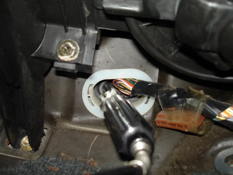

its eastiest to go through passenger door or take it thru the center of the dash and poke a hole in one of the rubber plugs..
than you can run it under the carpet or thru the plastic mouldings but it really simple lol hard to explain though....

the one by the battery taked it behind the dash thats the one i useed than take it behind the glovebox into the pplastc mouldins at the bottom of the passenger side door

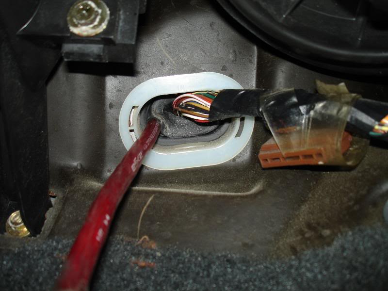

Old May 1, 2009 | 05:10 AM

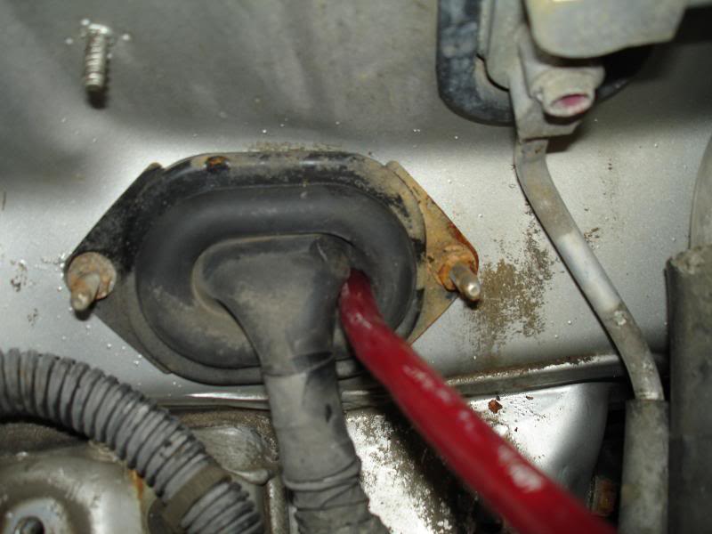

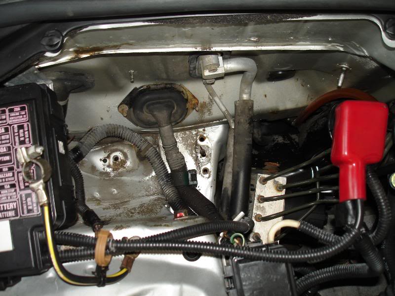

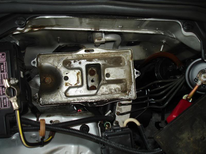

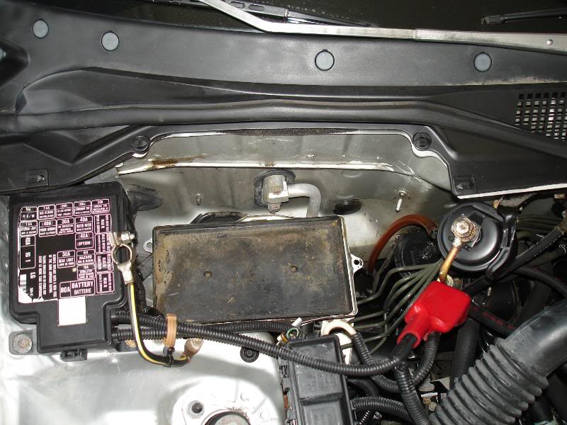

pull the battery and battery box for the best way into the cab....
3 bolts holding the battery box down,

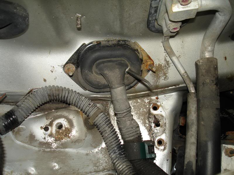

use something small and sharp to poke thru the inside gromet CLEAR FROM THE WIRES!!!!! poke it thru the center of the vehicle side.
then when your sure the probe clears everything then use a knife or something sharp to make a larger slit and then push the wire thru from the inside of the cab.
easier this way since you dont have to pull the WHOLE LENGTH of the power wire thru the firewall.
just be sure to move the wire clear of the battery box when you reinstall it.
