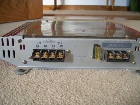

So while at work (residentual construction) the other day, the homeowner was cleaning out his garage... I'm washing out a cement mixer and the owner comes up to me with an amp in his hand and asks if I want it (cool guy, I ended up b/s-ing with him about bikes for a while after seeing his Hayabusa sitting in the garage). And, of course I took it.

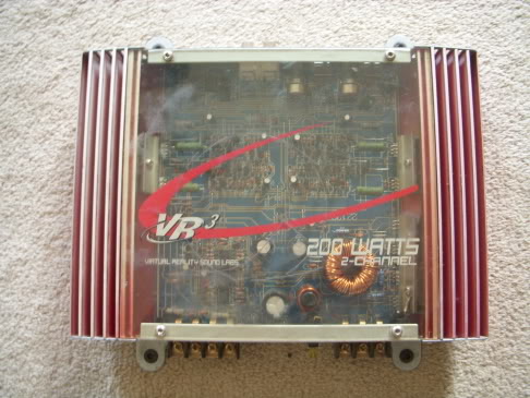

It's a Virtual Reality sound lab 200w 2-channel amp. The guy said he didn't know if it still worked or not, but I figure if it does, I have a small amp to hold me over until I get a better one... if it doesn't, it's not like I paid anything for a blown amp.

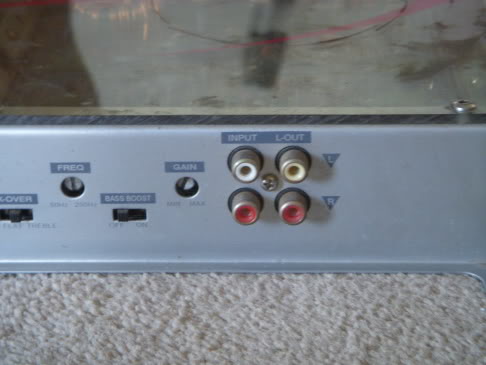

Anyway, I need help figuring out what to wire where (I've never done anything with audio before other than wiring up head units)... I'm assuming the one labeled "power" goes to the battery, the one labeled "ground" gets grounded (what about the remote one?)... and obviously the ones labeled 4-ohm subwoofer go to the pos/neg terminals on the sub (hows that for lucky? The sub I have sitting in my room is 4-ohm)... but the ones labeled input and l-out... do they go to the head unit? Because that's what I'm assuming, but I very well could be wrong lol

ok quick Breakdown...power obivously goes to the battery (make sure you have a fuse block somewhere in between ur battery and amp, under the hood is the most common location), for the ground make sure u have a nice bare metal location to ground the amp to wire brushes or bfscrewdrivers usually doo the trick for me, the remote wire goes to the blue wire coming off the back of your radio, red/white in/outputare the location for your RCA wires which also run to the "sub" output on the back of your radio(your only going to use one set of thos plugs red/white obviously), and the (+) and (-) are for the speaker wire that plug into the back of your subs...hope this helps...lemme know if you have any other questions

okay, thanks a lot... I was pretty sure about everything (except the remote thing) but just wanted to make sure before I went and hooked everything up.

the remote wire is the blue one in the back of the radio it sends radio signals from the head unit to the amp...it should come in your amp wiring kit....just run by walmart and pick up an amp wiring kit 8 gauge wire will work just fine....theyre like 30 bucks

ORIGINAL: ATL96LX
WAIT WAIT WAIT!!!
the blue wire on the backof the radiois a power antenna lead
the remote turn-on wire is bluew/ white stripe.
if you hook it to the solid blue, the amp will only work when you are listening to the radio but not cd, ipod, etc..
or you can just go strait to the ignition
