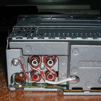

all you gotta do is strip the speaker wire as much as you can, wrap it a whole ****load around the RCA shell and ground the other end
or do this

wow never seen that done.LOL but then again ive never had that problem either... one thing i do always do tho is ground the radio to the dash frame, the factory wires are never large enough for aftermarket radios.......

just solder a piece of 18 gauge to the neg housing on your rca line.... iv'e done it many times it works like a champ

The one thing that stands out in your description above is "a pioneer deck." Pioneer is known for marginal internal ground planes, and especially for introducing ground differentials (i.e. loops) between front and rear or sub line outputs. Try ensuring a good ground for the HU that is not the OEM wiring harness ground, and try connecting the two outer rings of the RCA cables together.

No you do not. A single RCA will do the job. If you take apart the HU and look at the couplings themselves, you'll notice they are all on the same metal plane, therefore grounding multiple will be no better than grounding one.
