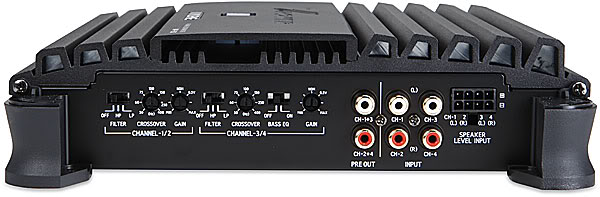

this is the amp i got. how would i connect the wires to the amp using the y connector posted above
