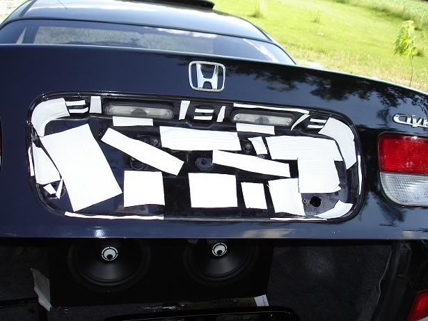

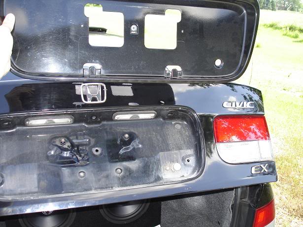

BUT also i should say for the dynomat.... FIRST find out what is actualy rattling!!!!!!
with just that you shouldnt have much rattling at all!
im pushen a 12 with 1200watts and only rattle i had was the trunk trim plate and liscence plate... and those can be fixed with the cheap stuff!
i used some 12dollar peel and seal stuff from menards.. think its like gutter guard or something.
and tho i still have alittle rattle from my liscence plates lower mounting point... i just havent slaped any foam strips on it yet...
but if you want to spend that much money go right ahead.... its your money!
but if 15bucks can fix it instead of 100bucks ro so... which would you rather spend?
and i also used dynomates EXTEREM lisce plate kit... cause i won it afew years ago at a stereo comp with my trucks stereo and never needed it till i got the civic.... and lets just say it didnt work at all!. and i refuse to use thier plate cover... that just screams... I GOT A NICE SYSTEM STEAL ME!
this was my problem area

only thing i have to do now is get some camper shell foam strips and pull the liscence plate again and just apply it to the back of the liscence plate. and its all self adheasive so its all easy as peel off a backing paper and sticking them on
