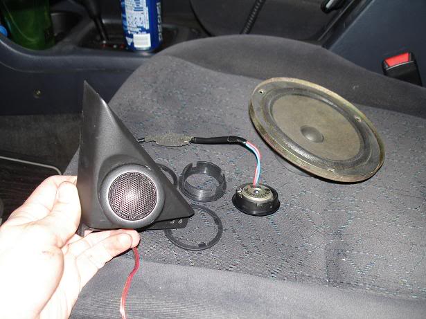

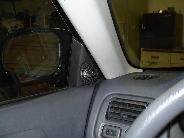

I have a question about the tweeters. Where did you find those pods for the tweeters? They don't look stock. My boston tweeters were never installed because they are about 1/4" smaller and I have yet to find any aftermarket pods that would fit that size.
Old Oct 25, 2008 | 02:40 PM
those tweeter pods are stock EX mirror covers....
if ur tweeters are to small try using the trim pieces that came with your tweeters to make them fit.....
i used one of the trim pieces that came with my tweeters to make them fit snugly.... i didnt use the rear locking washer tho since i didnt need to.

and heres a picture of my stock tweeters...
mine match stock very nice. only difference in looks is my outter ring on the tweeter is alittle wider than the stock tweeters.

lol I dont think mine came with trim pieces, just mini pods that don't match up to the car or stock pods

The CDT tweeters just dropped right into the pods, but I had to cut the notch that kept the stockers from rotating. I was even able to utilize the same factory screw after I pulled the back plate off of the TW-25 tweeters!
