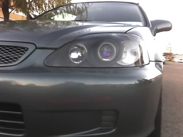

yup that seems to be the problem but mmm Caine714 wut kind of head lights do u have because on the pic you have the ring around the headlight is on and i think i have those same headlights but the ring isnt connected
Old Dec 28, 2006 | 08:21 PM
Caine714's Avatar
Posts: 278
Default RE: need help asap!!

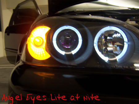

My headlights have 2 halos.My avatar shows the halos turned on without the headlight on. lol. the glare from the
parking structure is what you see.
here's myhalos:

yup same headlights
did u wire the headlights? cuz i bought my car last friday and the guy told me i just have to plug em in but i dont know how?
Old Dec 29, 2006 | 12:48 AM
Caine714's Avatar
Posts: 278
The angel eyes have 2 wires each that you have to connect. You need
to connect them to the turn signal wires (2 wires).
The headlights are just plug and play.
Old Dec 29, 2006 | 12:52 AM
**Alan**'s Avatar
Posts: 397
so for both halos one i head light its 2 wires ? cuz all i see is 2 a red and a black
Old Dec 29, 2006 | 01:16 AM
Caine714's Avatar
Posts: 278
IF YOUR HEADLIGHTS ARE THE SAME AS MINE (WITH 2 HALOS) THEN YOU SHOULD READ THIS:
Each headlight should have a total of 4 wires (2 red and 2 black) directly from the Angel Eyes. Now, go to your turn signal wires and seperate them.
I believe it should have 3 wires.
Separate the 2 wires that are Ground and Fire. Usually they are Red and Black wires. However, in this case the Red wire might be a different color (like mine was). If you dont see a red wire, i recommend you test out the 2 wires that are left over to find out which one has the electrical charge.
(I had to test the turn signal wire for the Red wires, because it was a different color.)
Match the2 black(Halo) wires, with theground (black)turn signal wire.Next.
Matchthe 2 red (Halo) wires,with thefire (whatever color it is)turn signal wire.
-- Now you can either, Very gently, make a smal slit through the plastic covering of the wires and connect the angel eyes that way.
Or
-- Cut the turn signal wires and expose the internal wire, and connect the angel eyes. (dont forget to use electrical tape to wrap the connections).
When you think you have everything done, turn on your "Parking" lights and the angel eyes should light along with the [yellow] turn signal bulb. Do the same for the other Angel Eyes, and you will have a great pair of angel eyes (like mine).
