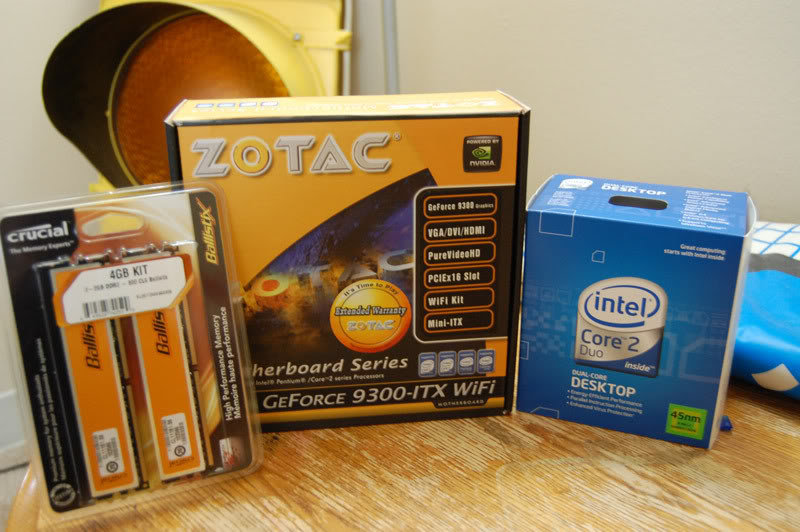

All the stuff so far

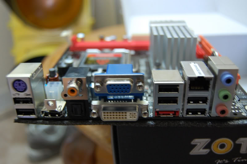

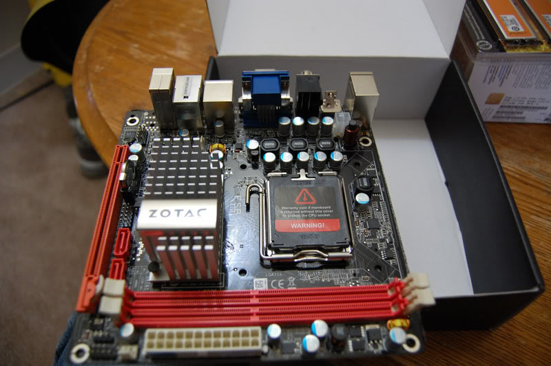

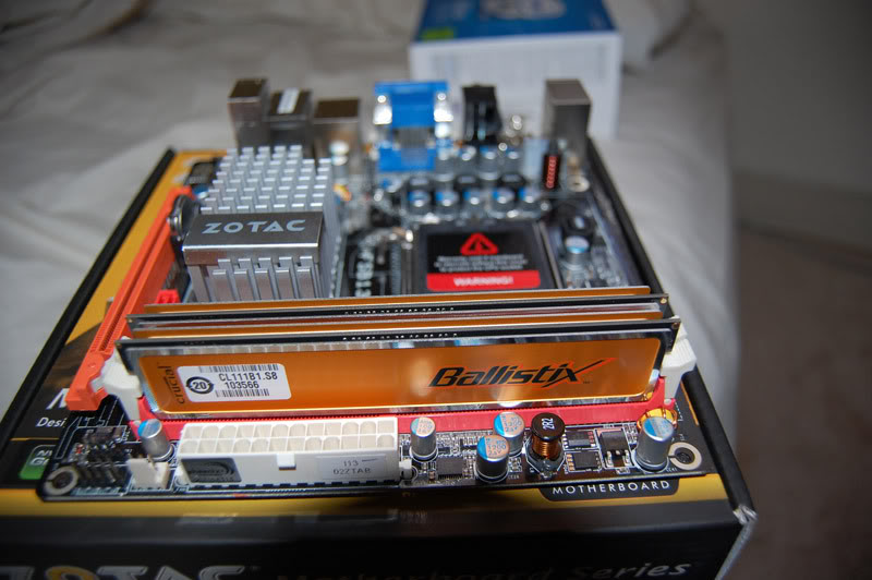

Mobo out of the box

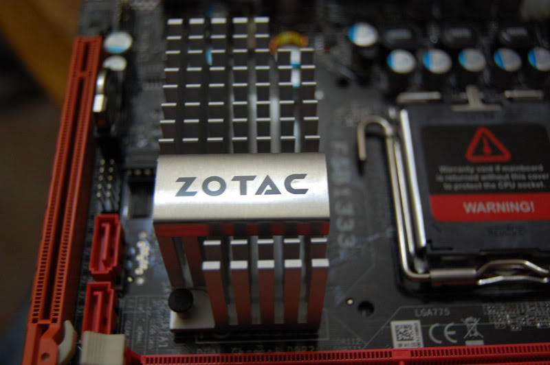

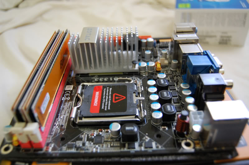

RAM installed

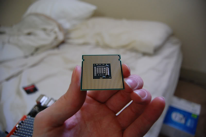

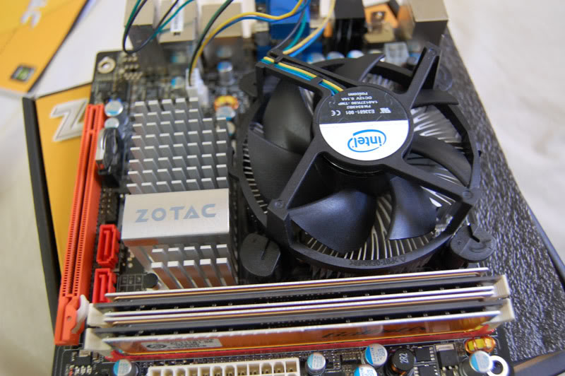

CPU install

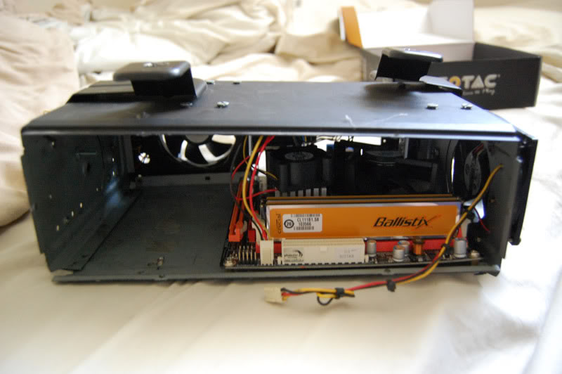

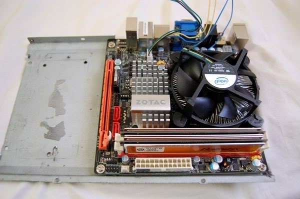

Put the whole thing on the case bottom its going in which is a gutted cd changer to keep the stock look in the trunk

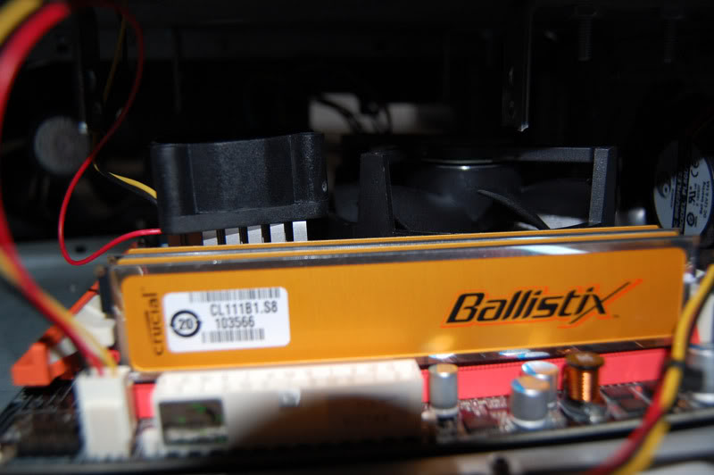

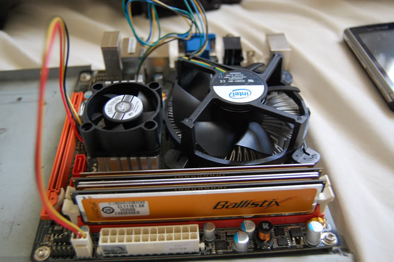

working on attaching a fan to the northbridge/graphics chip as it gets really hot without one, might have enough room for two as i dont want it to burn up
CD changer top on still need to install the hard drive and power supply once i get them but this is what it will look like

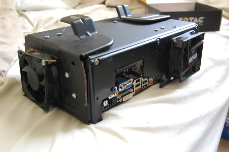

One intake fan near the processor and an exhaust fan on the other side

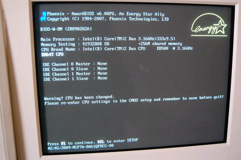

YAY it turns on
should give you an idea how its built

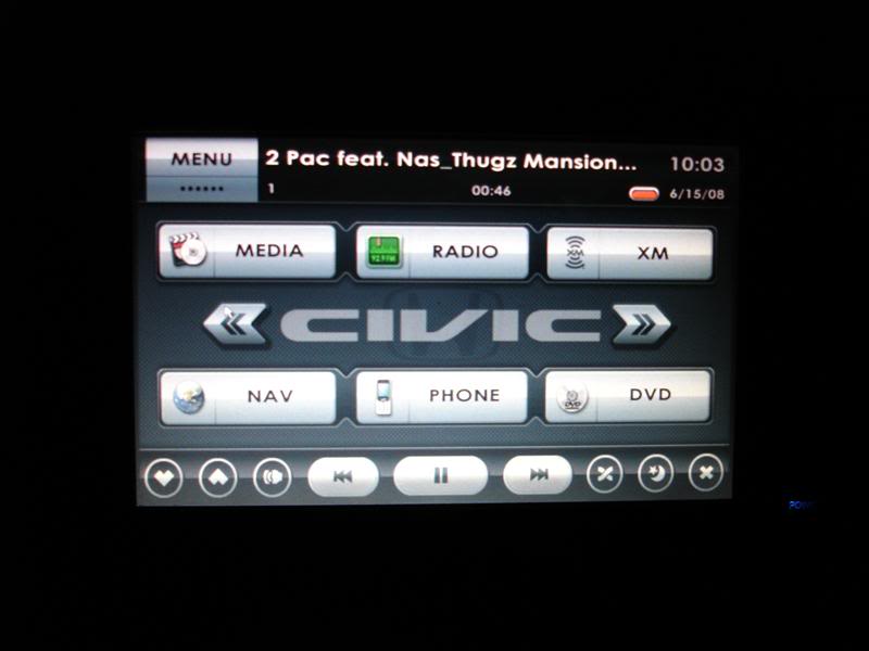

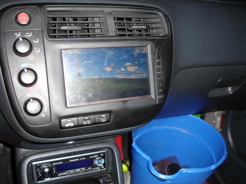

The screen is already in the dash this is the 4th one i have built over like 4 or 5 years haha

that is pretty cool. what are some things that you can do with this thing? is it like a computer or like a in dash dvd/cd player?
Old May 20, 2009 | 04:56 AM
justinwebb's Avatar
February 2010 ROTM
Joined: Aug 2005
Posts: 650
From: Columbus, OH
anything a PC can do it can do as its a mini pc which is far superior than any in dash dvd unit haha I use it to play mp3's watch movies music videos, wifi access, internet, OBD information, GPS, satellite radio, phone, web cam in the grill to record auto cross and such, it tells me gas prices around me and just about anything else you can think of it will do.
