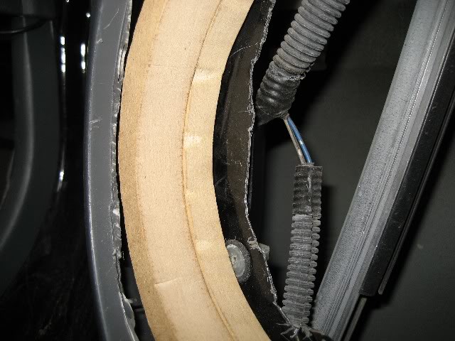

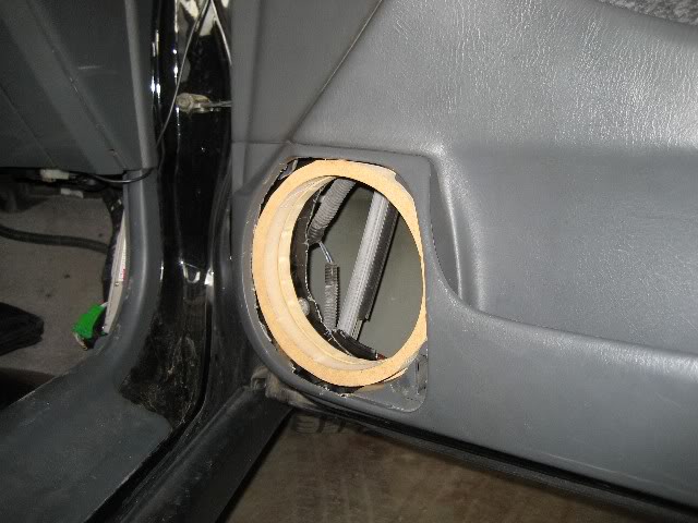

+1 on the spacer rings. I have a 99 and had to make some out of MDF:
