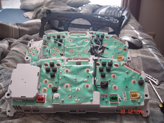

i got it i just went to the honda dealer and danny the service manager did it for free! im pretty tight with them up there so i was pretty happy. no more srs light haha but still the DAMN abs light

stupid question but does your DX have abs?

haha nope. the cluster thinks my car should have abs since i swapped clusters from an ex. so since its not there, the cluster detects a problem and the light stays on[:'(]

Yea...... if you don't have it, pull the bulb

dito.... just pull the bulb. tho i believe to get that bulb you gotta pull the cluster apart at least the clear bezel and then the black bezel and you should be able to get to the bulb...
OR if your DX didnt have that orange plug in the back of it.... just leave it unpluged
