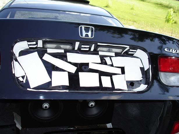

your problem area will be the trunk lids plastic liscence plate trim panel along with the liscence plate as well. very simple to keep the rattling down!

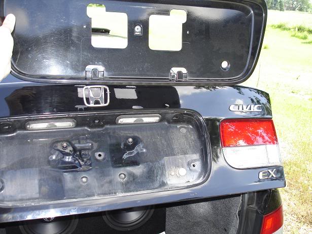

this is what i did on my trim panel... and used some camper shell foam and some hot glue on the liscence plate... i slaped some of that dynomat liscence plate on my plate and it didnt do a dam thing!!!!!! good thing i didnt pay for it! i won it afew years ago at a stereo comp when i had my truck.
main thing with the liscence plate is it doesnt have a attachment on the bottom... so its got about 1/4-1/2inch to just vibrate!
then put 2 strips of the foam stuff along the top and bottom of the liscence plate almost full length side to side and then with the plate mounted use a hot glue gun lightly push in the plate on the bottom, and put some hot glue right around those 2 lower lips and just let go of the plate and wipe alittle of the glue off if you put to much on it and let it cool for about 5mins before moving the trunk/plate or turning on the stereo. once the glue is cooled and stuck good your plate should be held firmly enough so it wont rattle as much.
