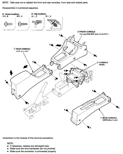

Hey I got a 98 civic EX Automatic and I need to figure out how to get underneath the shifter consol to change my light because I think it's gone out or something. Also on how to get the radio out, is it just supposed to pop out because I dont want to break it. I've been having problems with the radio when I plug something into the outlet it will make it all staticky. Does anyone else have the same problem? If so please let me know so I don't have to spend 5 hours trying to tear it apart.

Yeah, Trust's above thread on stereo removal is fantastic.
Here how to remove the console:

Yeah those are nice if you want to pay $5. I'm a tight wad and I'd rather just figure it out myself before I pay anyone, just thought someone could give some quick directions, mainly on the shifter part if anyone has taken one apart. Also if anyone has a solution to that radio issue I have let me know.

sweet thanks
