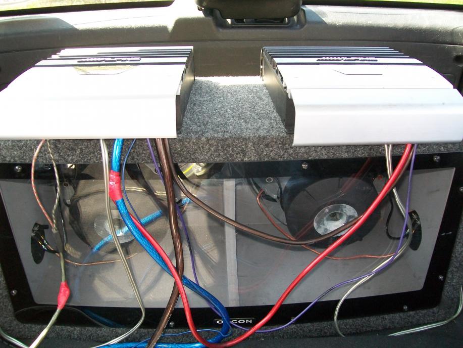

i have two 12" alpine subs in a bandpass box, carpeted the whole deal you know..
there are two 300w alpine amps powering them..
i installed everything myself with the help of a friend but one of my subs isn't hitting as hard as the other. it's noticeable just by looking at it..
here's my sorry *** pic of how it's set up;
question is, wtf is wrong with my 2nd sub?
if this pic is any easier, colors aren't the same, hope it makes sense :X

I don't see how amp #2 is doing anything with no input! You must feed both amps with an RCA input. If your head unit has only one sub output, use a RCA Y connector to split it into two. Head units that have "left" and "right" sub outputs actually feed the same signal to both outputs, so you can use a dual RCA cable to the front of the car and plug one end into each amp. No need to worry about left and right.
Wire the dual voice coils of each sub in parallel to make it a two ohm speaker. Parallel wiring means you connect both + terminals on the speaker together and to the + output of the amp, same for the - side.
Bridging an amp is a way to operate a 2 channel amp as a single channel. Since you have one channel amps in the first place, there's no concept of bridging. Wiring the power, ground, and remote in parallel like you have done is correct-- but don't call it a "bridged" arrangement.

I didn't put the subs in the box or do that wiring. I bought the subs how they are, all the internal wiring was done and in working order when it was showed to me.. If I can't bridge these amps, how would I get power to both of them and such?

The second amp has no rca input, you're right, but it still has a small bit of bass when music is played.. It's weird, I disconnected the second amp, so only the first one had power and was connected to the first sub- but both were still playing, what could cause that? It seems impossible.
My head unit has 3 RCA ports. "F", "R" and "SW", I'm guessing, front, rear and subwoofer so thats why I was only using one RCA cable.. I had 2 sets of RCAS so I cut them up so I could put one end into the HU and the other end had 2 sets of RCAS- one for each amp.
I guess I misunderstood what bridging meant, but things still aren't working right.
Is there any way to troubleshoot? This is driving me nuts

Both subs are NOT playing, it's the air pressure from the first moving the second. You NEED a pair of RCAs going to each amp.

that's what I was thinking, but it seems like its hits to hard to just be from the other amp..
so my problem is that my sub won't play if it's amp doesn't have rcas?

There is no signal going into the amp, so there will be no power coming out of it. The only reason the sub's cone moves at all is like the other guy said, air pressure from the one that does work since they're in the same box.
