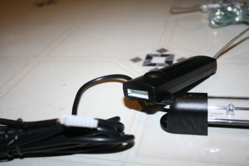

ok. so i bought my LED's today. but i have a problem.
they are prewired to hook up to a cig lighter. like this
<img src="http://i97.photobucket.com/albums/l2...billy/led1.jpg" border="</a>
i have 12g wire to wire it up with like JLGuy said.
but all the wires that are coming out of the tube go intoa plug like this
<img src="http://i97.photobucket.com/albums/l2...dconnector.jpg"</a>
and i believe that all the wires are 20g.
this plug goes into a controller shown here
<img src="http://i97.photobucket.com/albums/l2...controller.jpg" </a>
and that controller is connected to the cig lighter plug.
what should i do? how do i get those 20g wires to splice together with my 12g wire?
an answer asap would be appreciated cuz i am looking to do this today. thanks guys.

LMFAO....
give me a break guys...... i just got off work alittle while ago.LOL
and with the cigarete lighter wires is what you need to tap into...
simply get a light tester and with the plug wired in probe into each wire.... thiers only the two... ones power and the other is ground... once your sure which wire is which simply put some tape around the ground wire just so you remember which wire is ground or power...
then simply cut off the cigerte plug... and once ya got all the lights sure which wire is power and which is ground... just twist em all together... grounds in one and power in the other.... then twist on your larger power wire that you have conected to the switch... and just be sure to fuse the power source !
or if your lazy you could always just conect all the wires into cig lighter plug again and just plug it in and out when ya want them lite.... ghetto but works if ya realy dont care!
