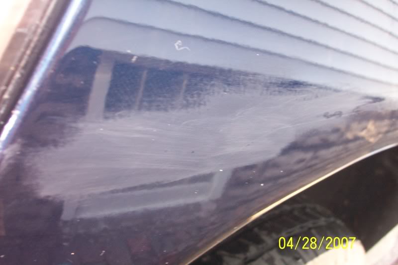

After the paint's dried you take 2,000 grit sandpaper and wetsand all the excess paint off that was left by the paintbrush. This isn't a hard process and it's not like you can even get your sandpaper in the crevice to sand off the touchup paint that's in there. Just make sure there's water on there a lot, My steps went like this for sanding: spray it down, do long fast strokes to get most of it off, wipe the excess with a damp rag then sand the rest of the small spots. do this maybe like 8 inches at a time and just keep at it it doesn't take that long and doesn't take much sandpaper at all. The left part here is stuff that i've already sanded and the part on the right is untouched.
So once you've sanded it all off the paint looks kind of cloudy, like this.
