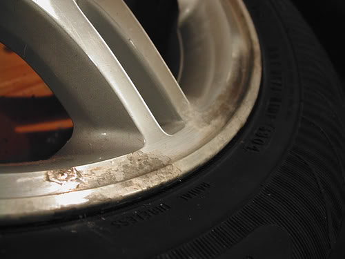

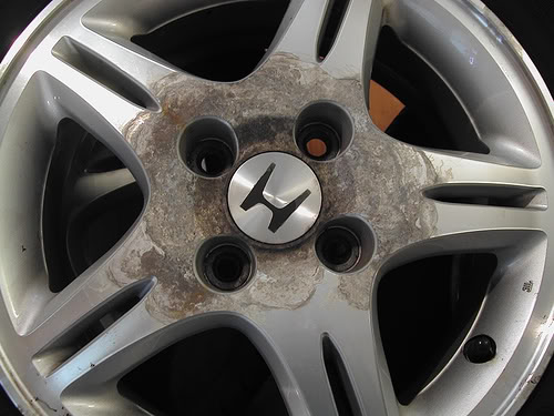

This is what my wheels looked like. 6 years of winter and road salt had been bad to them, and the clearcoat was chipping off in big pieces, leaving raw exposed metal below. I didn't want to shell out the $160 per wheel to have them re-machined, and I thought about having them sandblasted/repainted at a local shop but I procrastinated until it was about to snow and I HAD to put my winter tires on my car. So I sanded and repainted them myself in one weekend. This is how you can do it too.

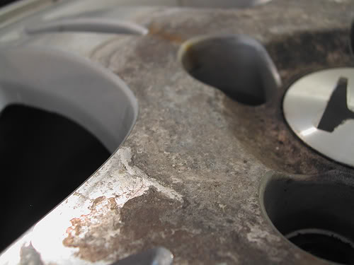

Here's a closeup of the bad part before I started:

and the edge:

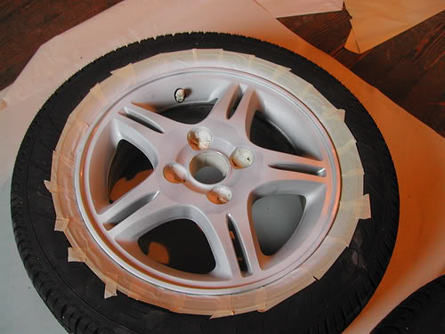

Next, use masking tape to mask off the tires, the valve stems, and the inside of the centercap/lug nut holes.
I also cut a big cardboard donut to protect the tires from overspray.
Spray two coats of primer on any areas of bare metal, allowing it to dry between coats (about 10 minutes).

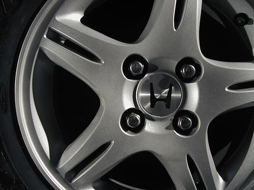

Remove all the masking tape and replace the center caps.
Allow the paint to dry overnight before re-installing the wheels.
That's it, you're done! Stand back and admire your work.
