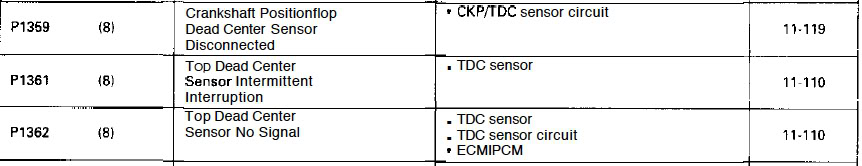

According to the code list at the website and the 96-98 Civic manual available for download (see below), code 8 actually indicates a problem with sensors in the distributor or with their wiring:
http://hondatech.info/downloads/Auto/Manuals/Civic/
If the sensor(s) is indeed bad, then the entire distributor assembly must be replaced; however, troubleshoot as described in the manual prior to replacing.

The eight flashes I noted were one second in duration. According to the site a one second flash equals ten, thus counting all eight one-second flashes I thought this would give me a 80 code. If the flashes were a half-second in duration that would be a single one, counting all the half second flashes would equal an eight.
page 11-54
P0401.1 (80) Exhaust Gas Recirculation lnsufficient Flow Detected . EGR line 11-170
If one were to get a code that was three one-second flashes followed by two half-second flashes that would equal a code of 32. Please correct me If I'm reading the flashes wrong.
