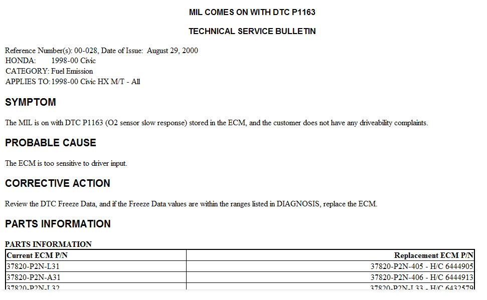

Apparently, since Aug of 2000 (the same model year of the car), they came out with a service bulletin that describes my situation and suggests replacing the A32 ECU to their new upgraded A33.
The dealership technician, previously, told me the ECU was bad and a replacement A32 would work. Then they told me the O2 sensor was bad and I had them replace it. However, their diagnosis was completely incorrect, considering it is still showing that the ECU is bad and the O2 sensor is bad. So, they have cost me $900 in parts that were completely unnecessary and they wll be fixing it at their cost, not mine!

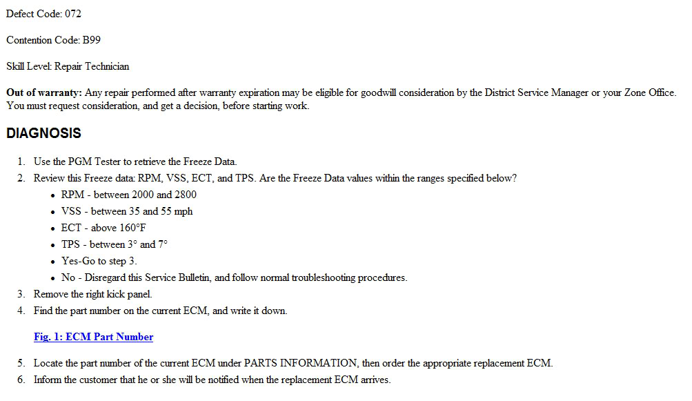

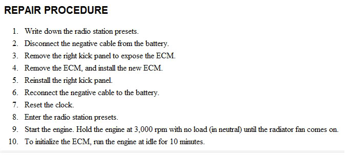

Old Oct 3, 2008 | 08:54 AM
Here's what I found with a Google search:

You found it!
