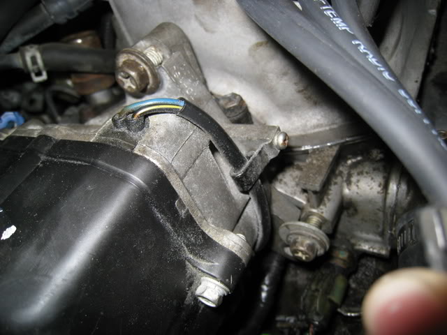

Otherwise there is no problem with running the stock dizzy. Here's a crappy picture of the modified bracket...

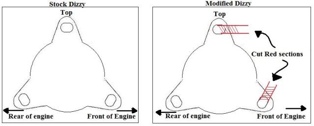

Here's a quick MS paint description:
Just not that you will have to get bigger washers to add onto the existing ones to be sure that the you get a good hold. You can see one of those bigger washers in the photo. Also, note that you should use a trial and error method. So, cut a little, then see if it fits. Have a timing gun handy.
Compared to the Z6 dizzy, the stock A6 dizzy will seemingly be vertical, where the z6 dizzy was on an angle.
If you really want to see where the dizzy has to be before you even start cutting, have someone hold the dizzy ABSOLUTELY still without it mounted, and find where the timing is correct. Make note of the dizzy angle and cut away.
