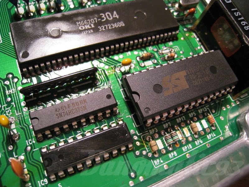

Went to junk yard today searching for whatever. I found this in a 94 ex. Its a p28 ecu, I know what the green box is, a socket, but what is the red circle??? I want to throw this on the bay or something, but i need to know what the heck this plug is used for? Tuning???

You found a non-virgin ECU. It's socketed for a chip and the ???? is a 4-pin header for data logging.

Ya thats the samething in mine same chip and same jumper wire for the manual. Mines a bit dirty lol...how should i clean the board up. its not dusty, just dont look the one you showed me. Also is it worth much??

Data logging is, well, for logging data. You can hook it up to a laptop and with the right software, you can tune your car live. It also allows you to see what's going on.

you can use any 28 pin chip (eprom). So, yeah, Hondata, Phearable, Crome.... ....they all have there ups and downs. I'm running a phearable chip simply because I don't have a turbo, so the advantages to getting Hondata aren't that great for me.
