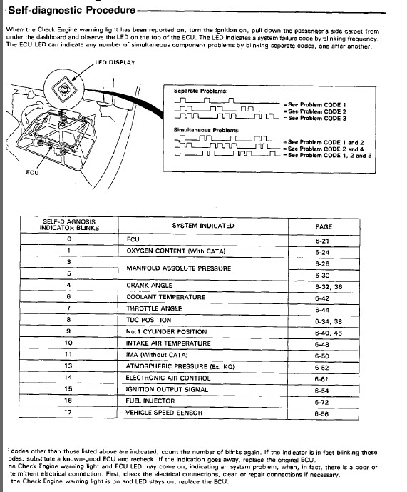

Check whether the ECU LED under the passenger seat is blinking a code.

i couldnt find the ECU LEDunder the seat

My mistake. The ECU is located beneath the carpet under the front passenger dash. One of these two diagrams should pertain:

k ill go take a look thxs
