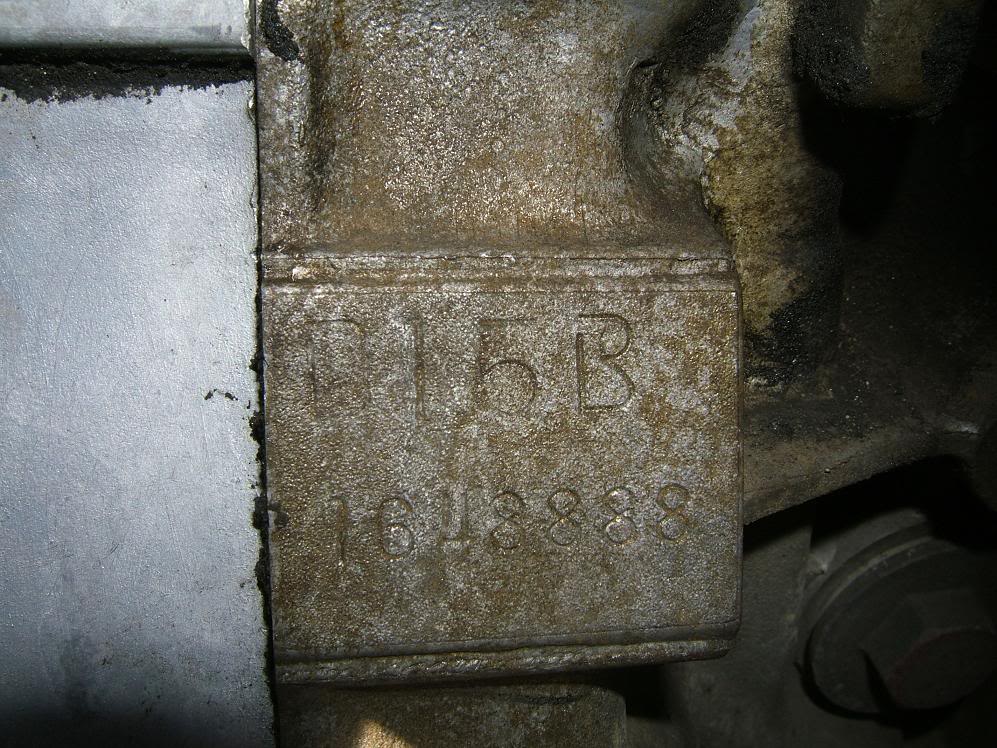

Forgive me if this is posted somewhere, i tried searching but it's kind of a difficult thing to search for. How do I identify what kind of engine I have? I recently bought a 1992 Civic DX but *the engine has been replaced* by a 30k mile one from japan. I've already learned that 92 civic DXs have D15B7s, but is it possible it was replaced with something else? Or is that like the *only* engine that fits and so there's nothing else it could be? Thanks a lot.

left hand side of the block, you should see it fairly easily.
Old Mar 6, 2006 | 09:29 AM
Default RE: Engine identification?
here ya go
[IMG]local://upfiles/2331/9ABD07AFEE6E44FC80AC3868A1B4938B.jpg[/IMG]

OK I located the code, it is in fact a D15B. But how can I tell if it's a b6 or b7 or b8? considering there's like a ~30-40hp difference between them?
Old Mar 6, 2006 | 11:18 PM
95dx28's Avatar
Posts: 211
Im assuming it has the big VTEC logo in the middle. if so then its just a JDM D15B. i just bought one.
