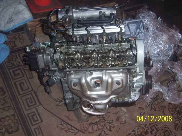

aight so here she is
I HAVE CROSSED OVER TO THE VTEC SIDE! muh hahahaha

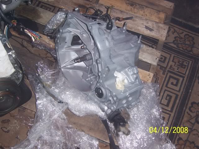

the Tranny!!!!

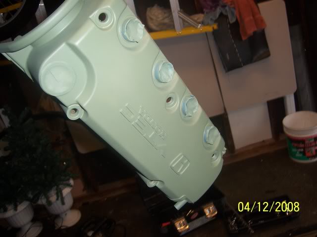

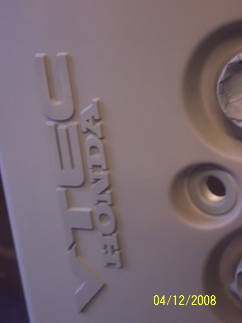

heres the valve cover i painted
step one take off that crappy black texture coating with rock miracle
NEXT self-etch prime the bare metal

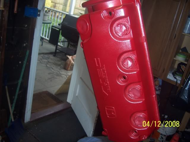

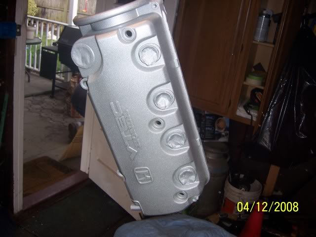

then put down the Duplicolor metal cast Ground coat
then the anodized color top coat***it doesnt look like it does in real life, it looks more anodized, its the same stuff i used on the valve cover in my sig...
