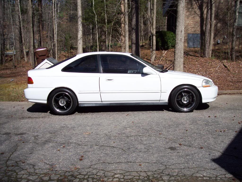

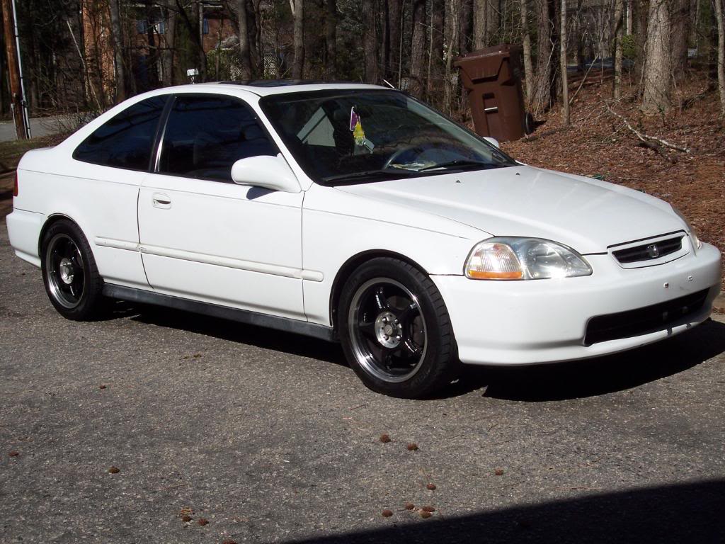

Old Mar 21, 2009 | 09:39 AM
Good luck with the search. And the EK's nice and clean... needs to go lower though... I love a nice EG/EK slammed literally to the ground
