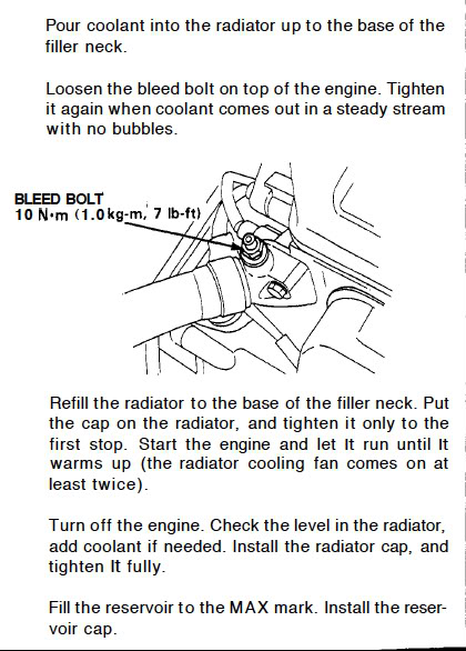

Try cleaning the FITV and bleeding the cooling system.
Bleeding the cooling system:
1) Park the car on an inclined driveway with the front end higher than the rear.
2) Push the dash heater lever/**** to MAX heat.
3) Follow the directions in the diagram below (hint: the bleed bolt is located where the upper radiator hose connects to the engine):

You should reset the ECU after replacing and calibrating the TPS, though idle surging is never normal. Bleed the cooling system and clean/adjust the FITV.
