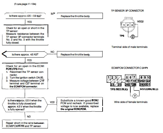

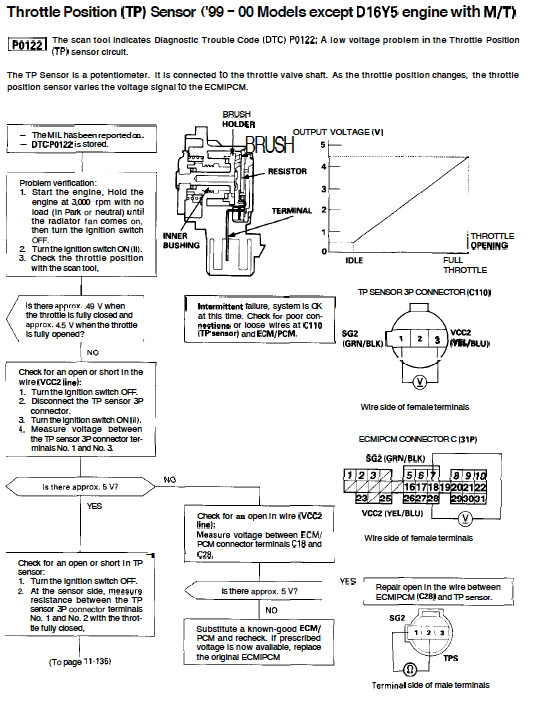

Does the CEL work? Did disconnection of the TPS throw a CEL? If not, there could be a problem with the CEL circuit or the TPS circuit. Here's how to troubleshoot the TPS circuit:

I agree that the TPS might be the problem, but you need to verify. Use a multimeter to do the voltage and resistance tests in the diagrams so that you don't replace the TPS needlessly.

It is possible to purchase the TPS alone. Try a Google search. The rivets of the old TPS need to be drilled out and the new TPS must be calibrated (0.5V closed throttle; 4.5V wide open throttle) as part of the installation.
