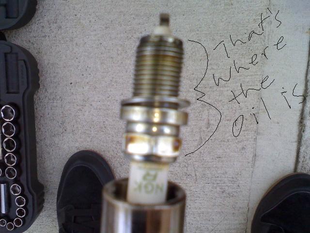

well...it started again not too long after my last post. i unplugged the tps sensor like bcivic sed to do but it still sputters. i did a compression test and the results were 200, 190, 190, 200. also im still finding oil on the first two spark plugs but not on the tip of the plug just where the threading is. i also asked my mechanic and he sed he thinks its the catalytic converter failing. here's a pic of the plug (cellphone pic)

My guess would that the oil on the plugs is coming from leaking spark plug seals, which are not the cause of the engine sputtering. You may need to replace those leaking seals again. Are you having difficulties with the installation?
With respect to the sputtering, have you checked the ignition timing?
