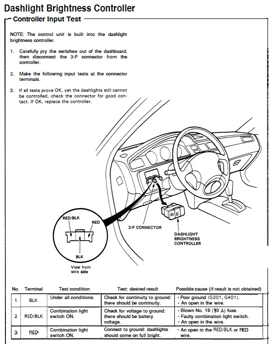

I have also noticed that when I start the car, and turn the lights on,
some of the lights on the dash won’t be on, and then a few seconds
later, they will pop back on. Other times, when I turn the lights on,
for about a second, none of the lights on the dash will be on, and
then they will all come on.

I have also noticed that when I start the car, and turn the lights on, some of the lights on the dash won’t be on, and then a few seconds
