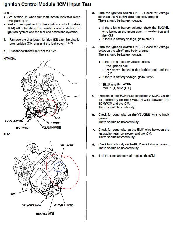

i took off my distributor cap and saw everything inside became light brown burnt lookin, and in side the cap were peices of this green/light green stuff. i dont know wat it is but i did see this black box lookin thing that has a positive and a negative wire comin from the ICM connected to it and has this long tube nipple lookin thing that looks similar to the ones where u connect the wires on the cap. now i dont know wat this part is called but that tube thing is cracked. can that be replaced or do i have to get a new distributor? i'll try to post a pic up later

this is the diagram of the distributor.... the part circled in read is the part i was talkin about. and the section circled in blue was the cracked part... can that whole part be replaced?

That part is the ignition coil. It is one piece all the way from the base with the small wires to the tower part. Having it cracked is very likely to kill the spark, so replace it.
Did you check for rotation? The rotor should rotate when you crank the engine.

it di rotate so i just might as well replace the distributor... so i did and now my car is runnin GREAT!!! thanx for da help!
