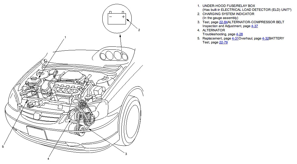

1) Check whether the alternator belt snapped.
2) Check whether fuse 19 or 20 under the hood or fuse 4 under the dash is blown.
3) Charge the battery and drive to AutoZone where they will check the alternator free of charge.
