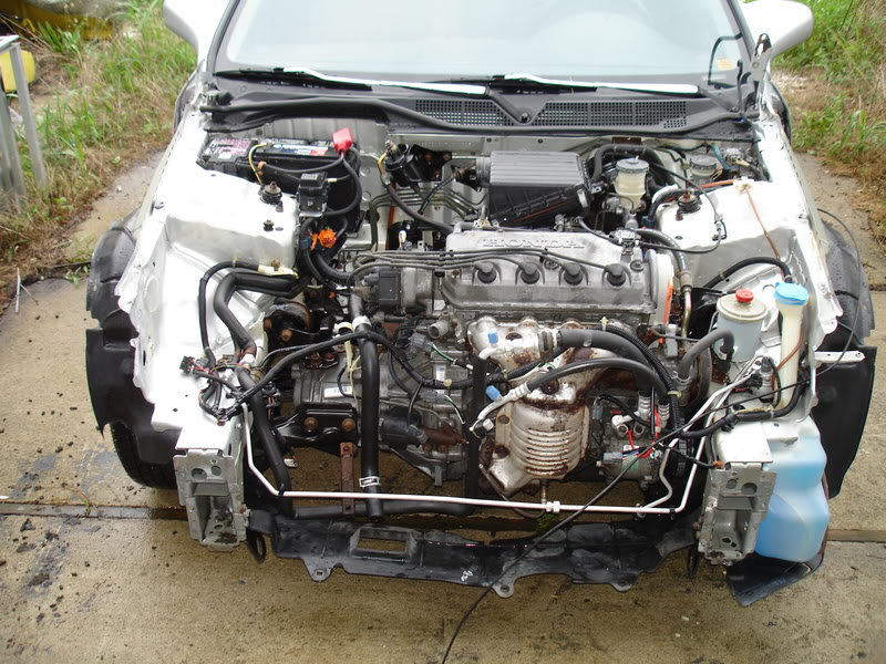

heres some pics, its probably gunna get totaled out if you compare it to V8DIEt's accident.
There is too much bent metal imo, my estimate from a shop is going to b 3.5k at the least.

well i must say THATS NOTHING!!!!!!!
if you have a friend with some a welder you can fix the car yourself!!!!
from looking at it that has a high impact and easily fixable!!! DONT LET THEM TAKE THE CAR.... get the money and buy it back!
all you need is of course the radiator support, hood, bumper cover, MAYBE the metal bumper support but from those pics it doesnt look damaged so i think its still usable. but if it is damaged its still pretty cheap.
youd need headlights, maybe the radiator if urs got smashed.... then if you want AC youd need a new AC condensor and posibly a few lines if they are crushed and a new fan for the condensor, then maybe the drier if you want to be safe and just afew Orings and have the system recharged at a shop... ruffly 150-200bucks to have it vaced and filled.
trust me you can fix it and save alot of cash!!!!

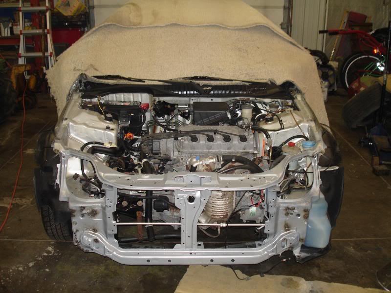

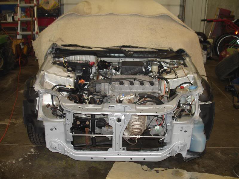

only tools you need is some spot weld drills, or just some drills will also work and a punch to center the drill on the factory spot welds on the radiator support, and a BIG F***en hammer, or alot easier with a air chisel to cut the factory support off, then just use a small welder to weld the new support to the car. even a small welder will work great! simply drill holes in the new support to get a better weld.
then just a simply hammer and hand dolly to hammer out some bent metal back flat after chiseling all the factory spot weld points.
after you have the radiator support welded in YOUR GOLDEN the rest is just bolts!!!!! and some paint. since your civic is black its VERY EASY to blend the black paint!
trust me i know this repair.LOL your fenders dont even look damaged so you can reuse them.
you can just spray paint the new radiator support black to match your car before welding it to the car, just grind the paint off and drill the holes for the welds and after the welds best to grind the welds to make them look alot cleaner and then clean and primer/paint them so the welds will disapear and stay rust free. then after you fit everything to ensure it fits and alignment on the panels are good, simply unbolt the hood and bumper cover and take to a paint shop and have them paint it black and you simply install it.

KEEP THE FAITH you can do it yourself with very little tools... i know you KNOW SOMEONE with a welder and afew air tools....
i fixed mine myself very fast!!!!!! hardest part for me was getting the money to buy the parts, i didnt have insurance money... wasnt my wreck or i would have had mine painted already.LOL

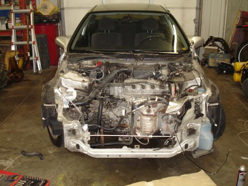

the radiator support is the hardest thing to replace but thats its. if you got all the parts it would take you about an hour or two to remove the old support with a air chisel, or alot longer with a spot weld cutter or drill and big freaken hammer and chisel... only about 30mins to have the new one tach welded inplace,
the hood bolt up with a friend very easily 15mins.
O YA dont forget to replace the hood latch also... and maybe the release cable if its busted.

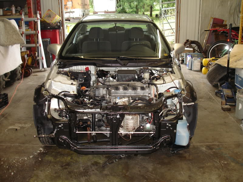

hey so i was looking at some of you pics from your photo bucket, and I cant even see where you welded lol

ya i painted the support, primered then paint then clear, all spray ans. then put the supprt on the car... drilled the holes for the welds, then grinded the welds down pretty smooth and then primered and painted/cleared those areas over the welds and just taped off the rest of the support and area to prevent overspray on other parts... turned out looking great.
and when grinding and welding be sure to slap something thick over the windshield and glass on the sides just to be safe, because if the metal from welding jumps around and hits the glass it will melt into the glass and never look right again...
