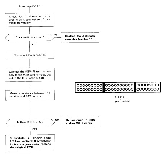

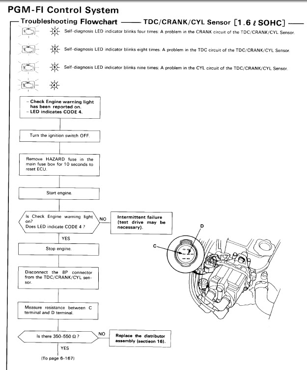

Alright I was able to look it up and it pulled a 4 which is crank angle, if I recall correctly that is part of the distributor that the whole thing needs to be changed correct ?
Old Jul 31, 2009 | 10:05 AM
if your car is mpfi then yes it is in the dizzy

Old Jul 31, 2009 | 10:13 AM
