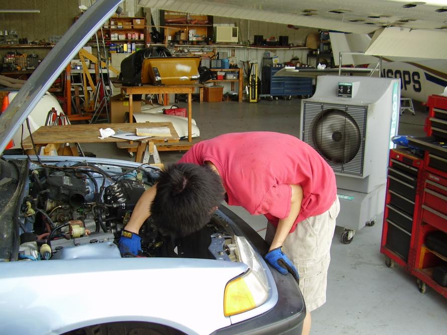

Old Sep 20, 2010 | 01:48 PM
maachan513's Avatar
Posts: 408
Well, that is my son. Trying to be an auto tech.
