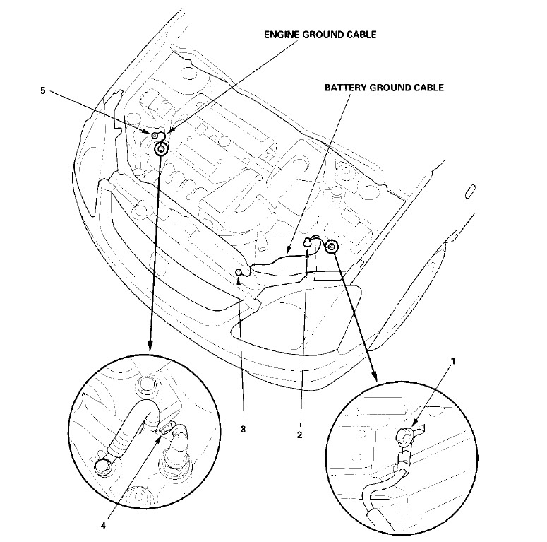

Check whether the battery ground wire attached to the frame is loose or corroded.

lement92's Avatar
Joined: Apr 2009
Posts: 37
no corrosion. and tight connection.
Old Jun 3, 2009 | 08:03 PM
Sounds like a battery connector or ground wire problem. Also make sure the battery connectors are tight and clean.
