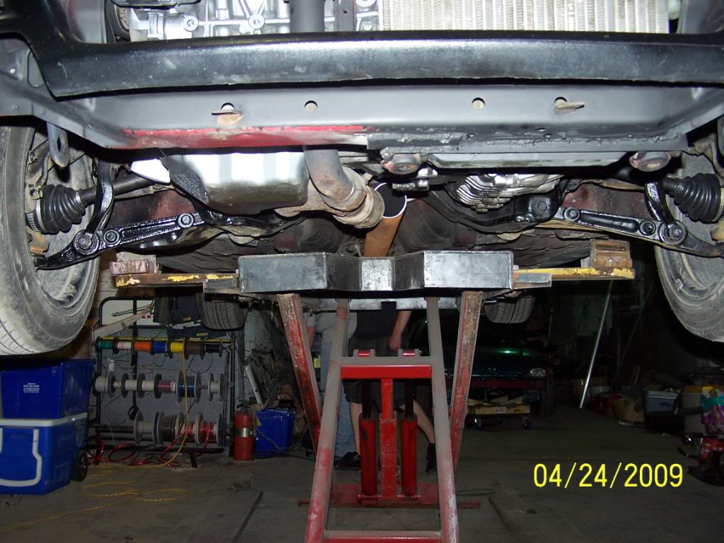

I appreciate the help. I think I found it, but I want to be sure so I don't bend anything. I'l try to attach a pic of what I think is the jack point. Is this it? :

BTW, I don't see any tow hooks on the front. And honestly, just jacking up the front and putting jack stands under the wheel well points sounds easier...I just don't know if the above picture is actually the proper jacking point, or something important that will bend. That's the only thing I see resembling a jacking point under the front of the car.

Top left corner.

ya the point in the picture is the correct spot. at least thats what i use.
and the only reason i put one jack under the passenger LCA and not the pinch weld is because my jack comes up about an inch short, so i cant fit my jack stand under there. so the LCA is the next best place

yep, that's it
