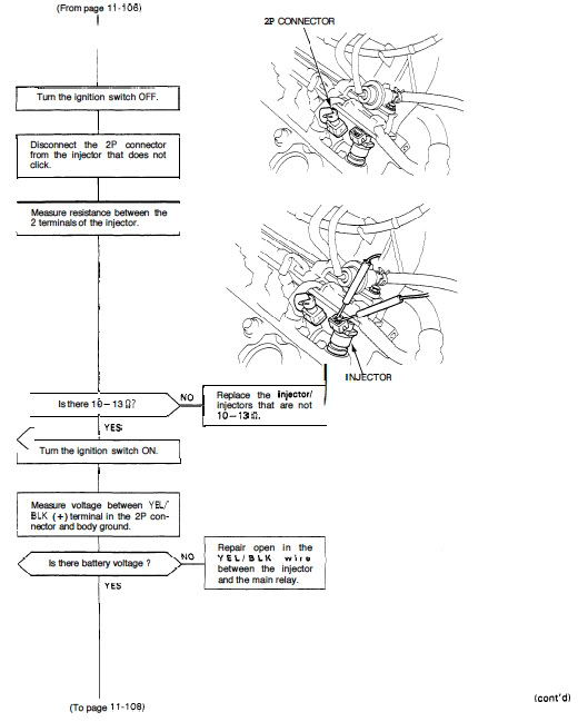

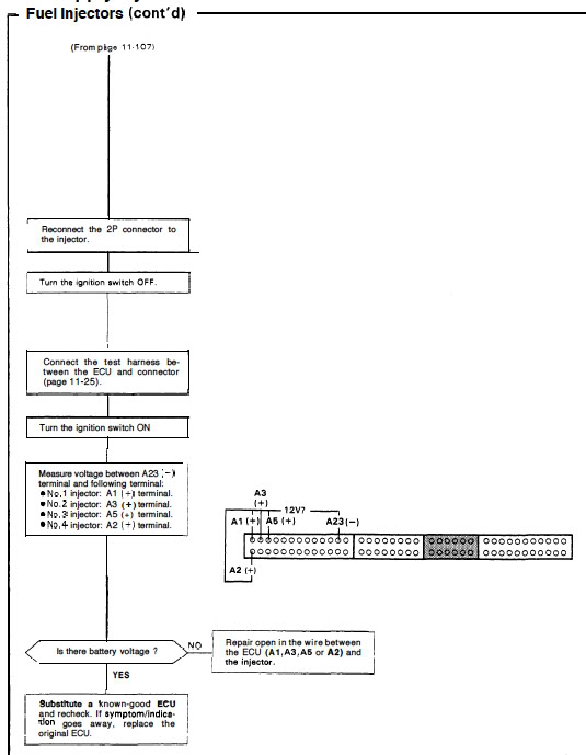

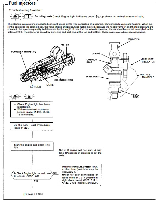

the code is 16...

the code is 16, the previous owner put in gsr cams and and a skunk intake manifold, he told me and I have been told by others that it should be tuned. BTW I kinda already figured out who stu was I just couldn't think of any other signature ha i wish I could go to florida right now
Code 16 is a fuel injector. It would prolly be a good Idea to have it tuned. What ECU are you running? Does it have a chip?

thanks, yeah i just looked that up myself, man that was a quick reply I am about to go through those tests. Thanks for posting those pages it made it way easier to find in the manual, that thing is so long, in a good way of course! This makes sense because it wouldn't start a week ago and i took out the plugs and they were completely fouled it looked like it was from running too rich, also the exhaust looks like it is running really rich as well,

So I tested the injectors and i am not getting any resistance between the prongs on the injectors, the manual said 10-13 ohms does this mean they are bad ? i looked up the barcode number for the ecu and it looks like it is the stock ecu for a 93-95 civic, im not sure if it has a chip, how can i check that
Old Jan 21, 2009 | 01:17 PM
Unless your multimeter has auto-ranging capability, you must select the proper Ohm range/scale to make the measurements. What scale did you use? If you touch the ends of the red and black probes of the multimeter together, the Ohm measurement should be approximately zero. Is this what happens? Are the batteries in the multimeter fresh?
